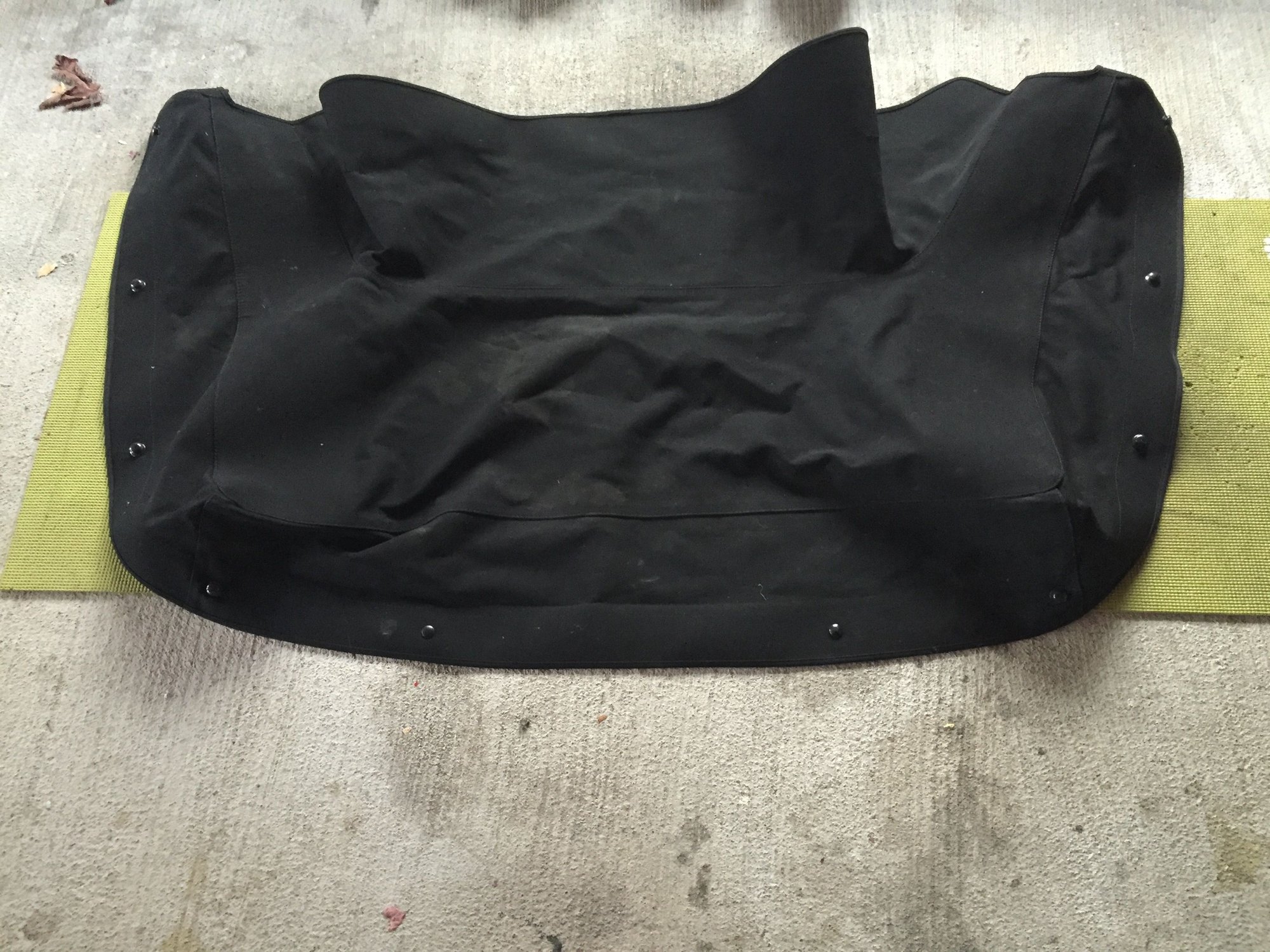

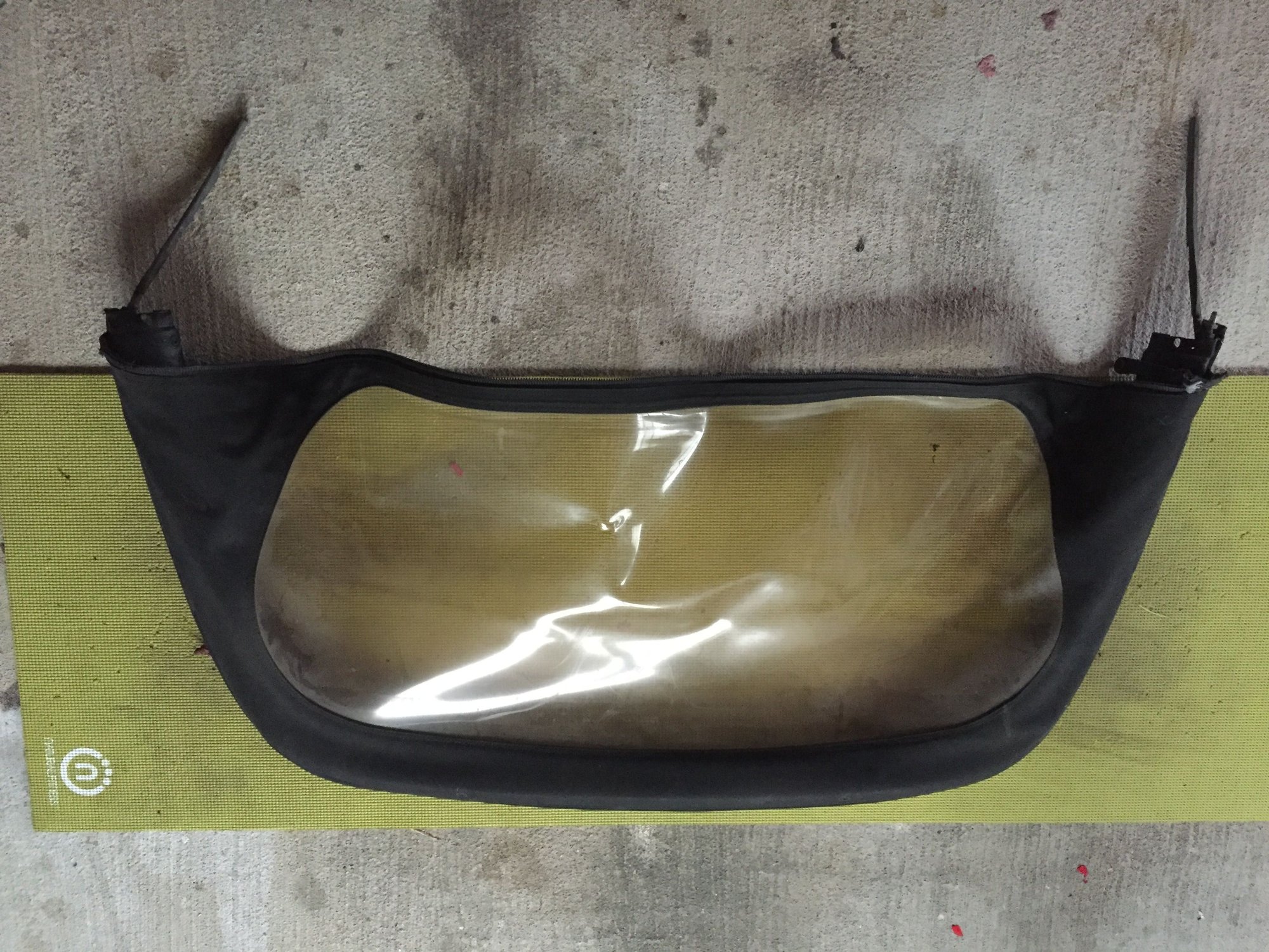

So I'm getting around to clearing the last of my convertible top items. Is this part number 91156102360 (FOLDING TOP COVER)?
I see it on the PET, but there's no way Porsche actually charges $4K for a new one, right?
And question 2:

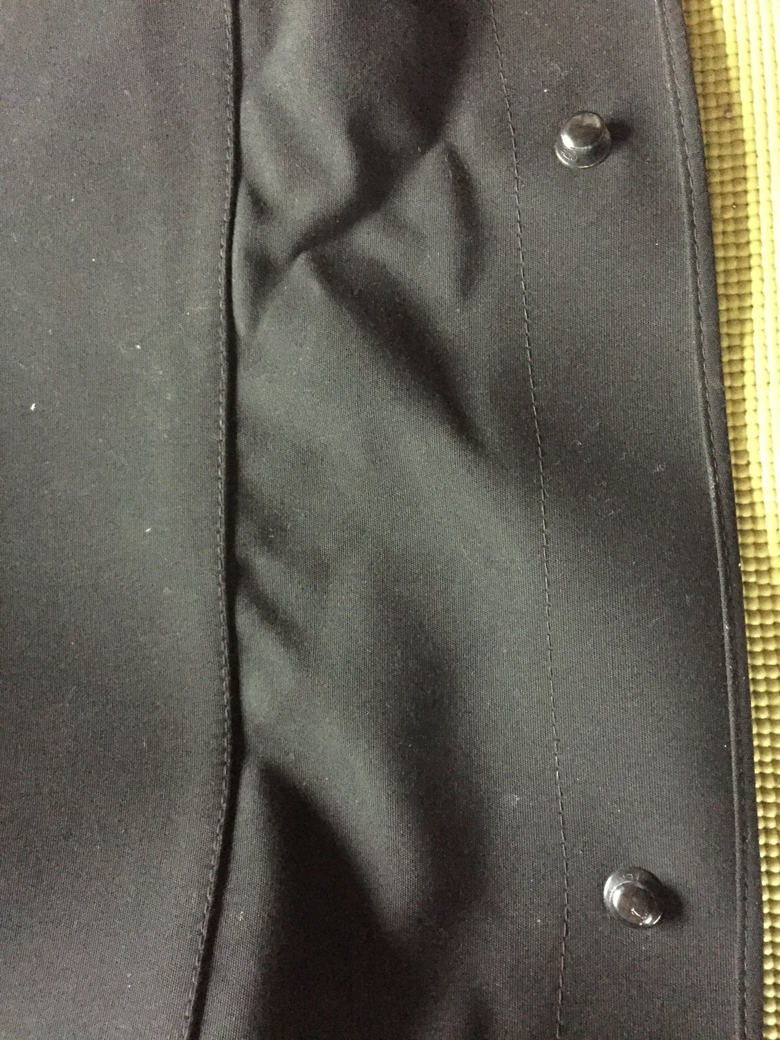

Is this swappable? I.e. should I just toss it, or will someone on Ebay (or here) have a use for it? Anyone know a part number for this?
It looks like it can be zippered "on" in the same way that I zippered it "off" my old top.
