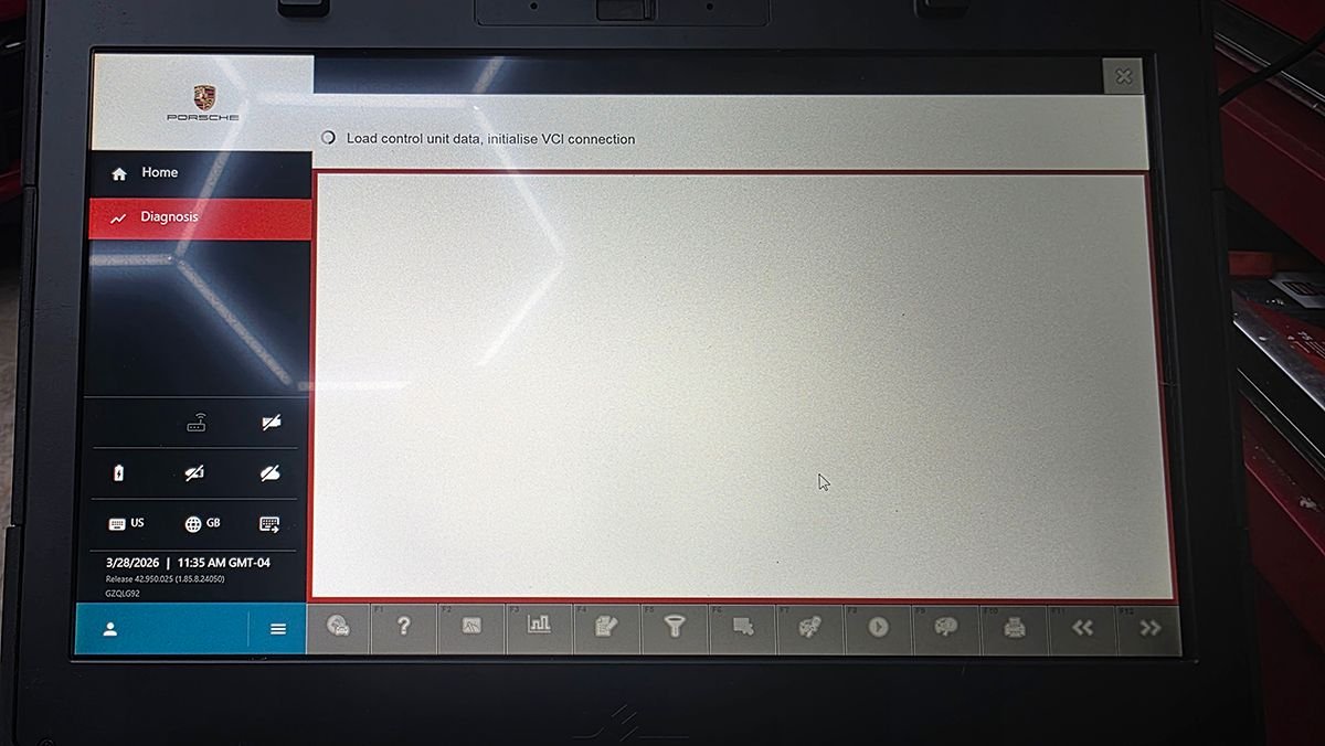

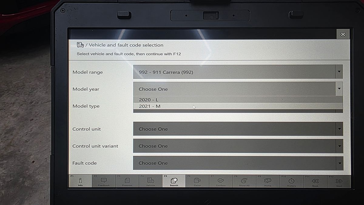

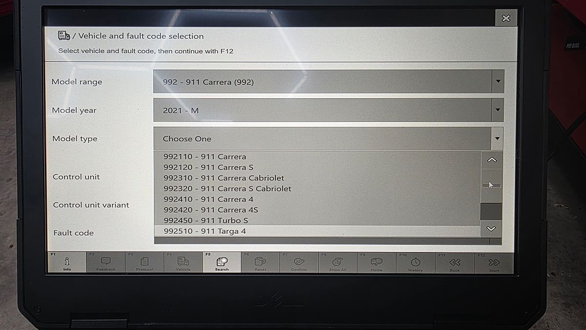

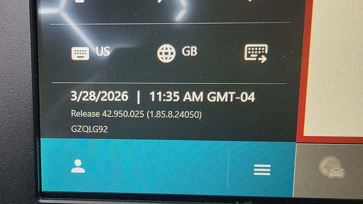

So - first, these are the version of PIWIS 3 and PIWIS 4 that I have (I do have older versions of 3, but I'm getting the same issues.)
Which this, the concern with PIWIS 3 is that the 2022 model year - and the GTS is not listed here.

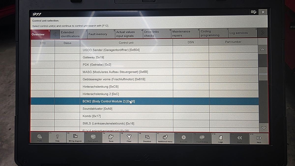

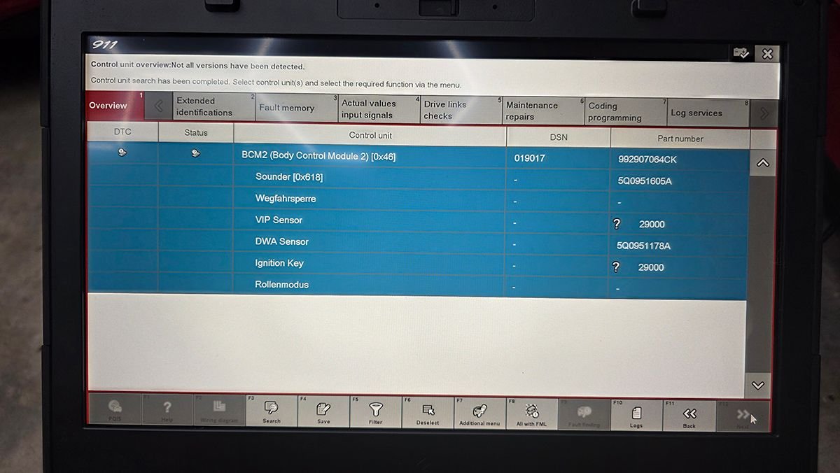

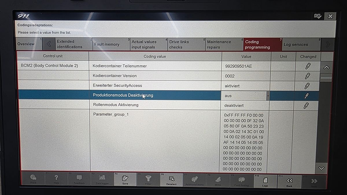

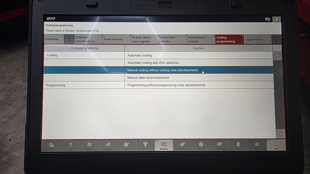

Now - when I go into version 3, engineering mode. I've been using the example of the turn signal blinks from 3 to 5. I would...
Go into BCM2 - selecting. F12

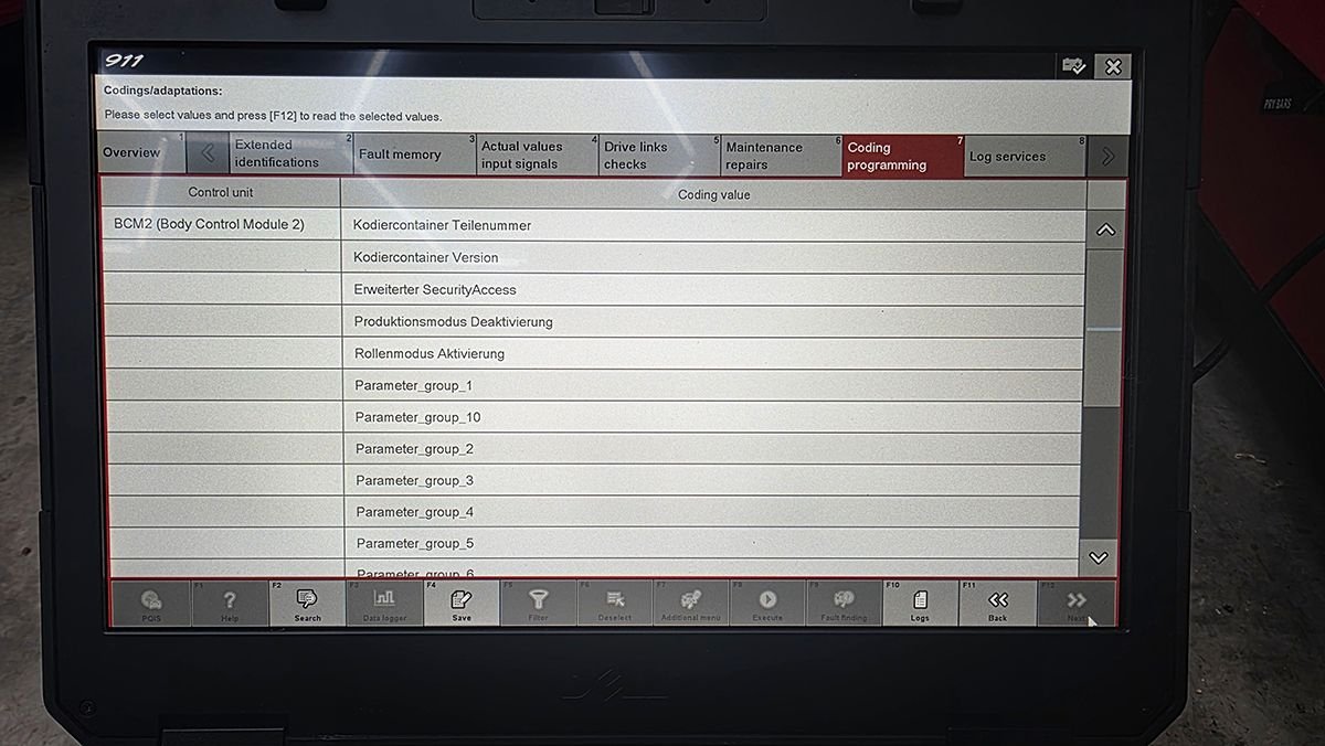

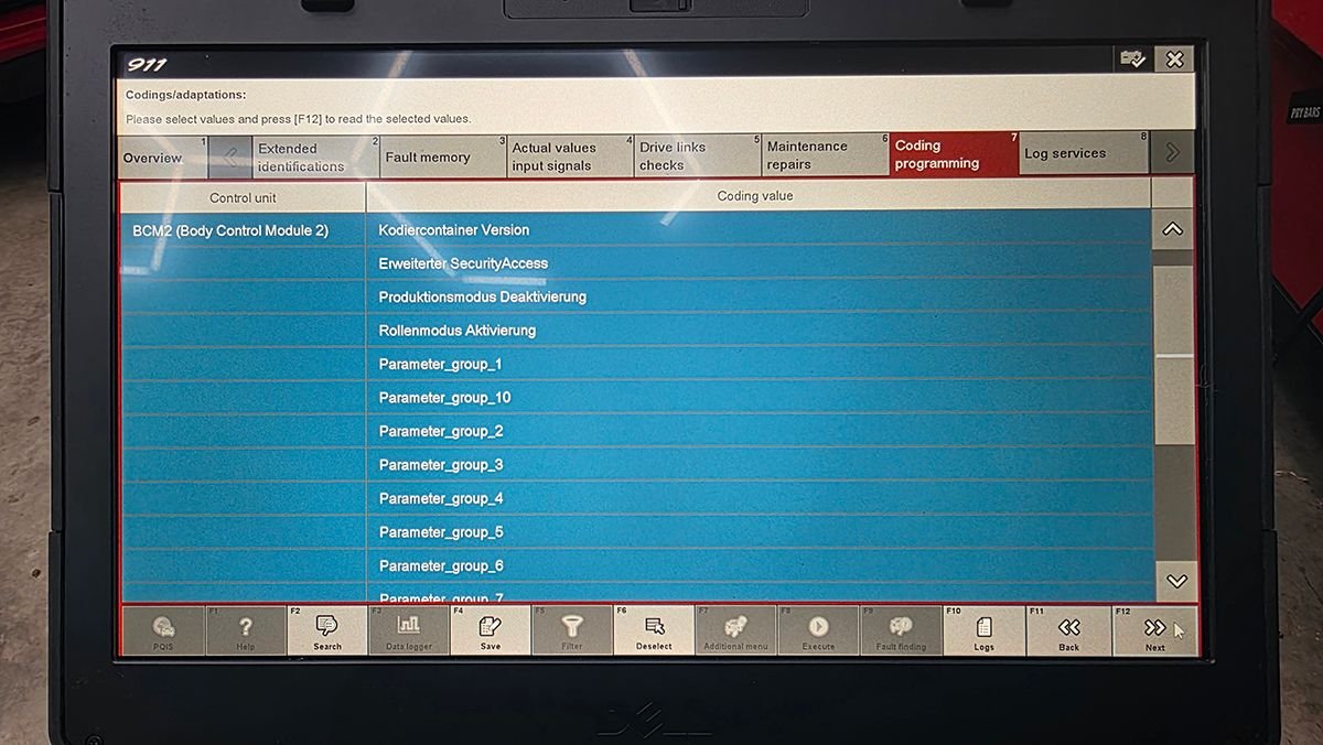

Highlight and select all options
Click on Programming Coding - Manual Coding without rules
Highlight all Selections again, F12 - Note that this is all I'm seeing.
And these are the only items that come up. When I do this on my 981, I see tons more in options...which I've also seen here in other folks screenshots.
I thought I took some screenshots of version 4 - but as stated, I can't see where to put version 4 into engineering mode. So when I go under configuration, everything is in English and there's no 'Manual Coding' option. Like it's in V mode.

Here are some questions:
1) Did your “older” version ever work? Where did you get this software?
2) I note your vehicle is not auto detected, which is where I would guess is the start of the problems
3) It looks like the slider under “Choose Model Type” can be slid down for more options?
4) My question again is why use PIWIS 4 on pre 2024 vehicles?
5) In your PIWIS 3, your ignition key is not seen or no data received (code 29000)
6 ) Should Produktionsmodus Deaktivirung be set to “ein” and Rollenmodus be set to “aktiviert”?
7) What dongle/sw version are you using?

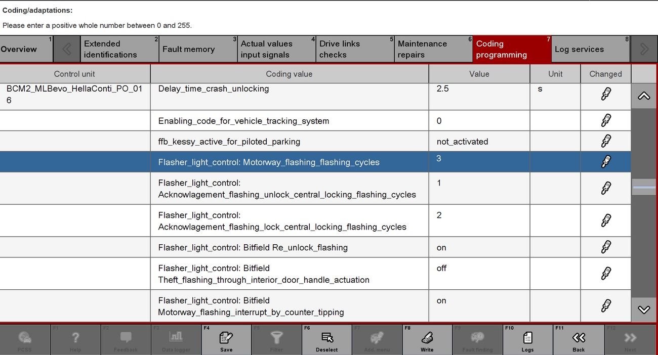

To set the number of blinks once you select BCM2 this is what you should see and select:
I think the problem begins with your car not being auto detected and as I mentioned I don't know why you're using PIWIS 4 on cars that can be adequately be scanned with PIWIS 3. Next is where you got version 3 and 4 since you say you're getting the same error?
HTH
siberian

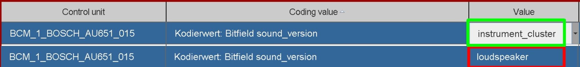

Problem solved, I found that I'd changed BCM1 > KW > Bitfield sound_version to loudspeaker. Changing it back to instrument_cluster fixed the issue. Clearly, ParkAssist sound output to loudspeaker isn't a valid option!

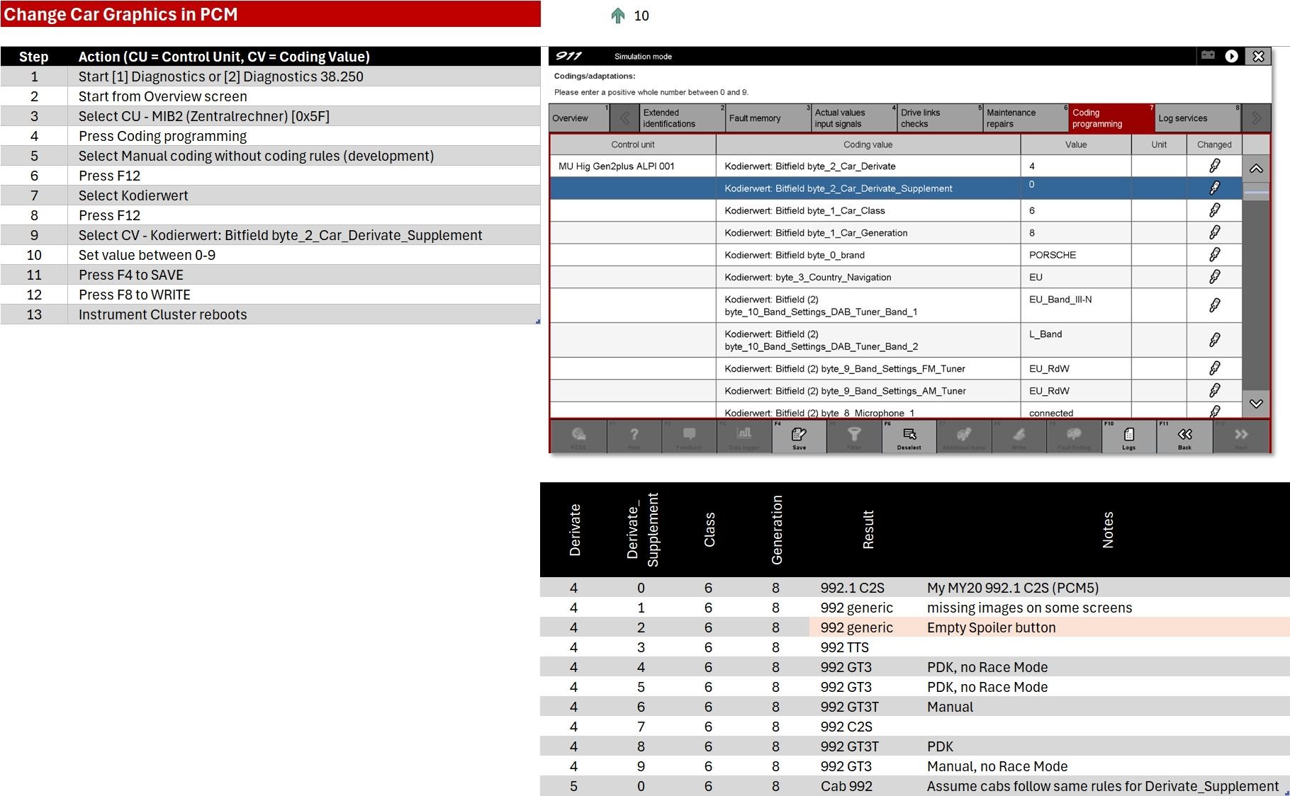

Check out my post #1198, you might need to change the car model in PCM (Control Unit MIB2). One combo I tried had an empty spoiler button, that may be your issue
I've also updated the table, see below
Charging the car model isn’t necessary. He just needs to go into the settings, deactivate the spoiler tab, then auto code.

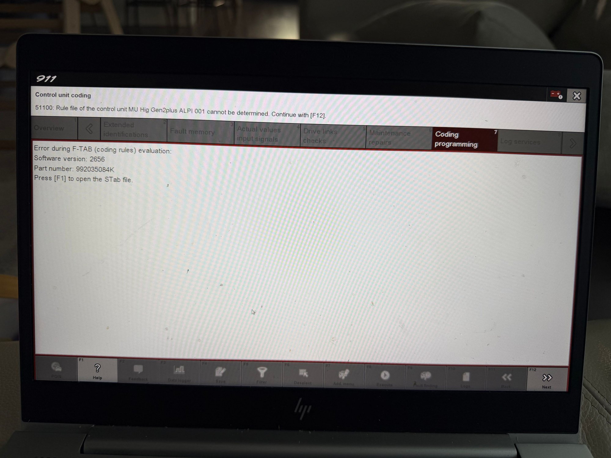

I have try both recommendation. Still no button on my screen. Auto coding did not work. It keep getting this error. Any help or other recondition would be appreciated. Thank you.
HTH
siberian

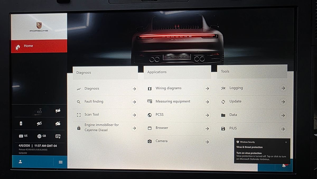

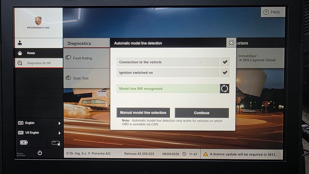

So - I can get it to autodetect...think I was just showing in the case above that the 2022-2024 GTS is not listed in PIWIS 3 (even if I scroll down). Attached - you can see the auto connect.
Guess my questions is - has anyone with a 2022-2024 GTS or 4GTS have success in getting PIWIS 3 to successfully code changes? Unless I'm completely missing the boat here (which again, I've coded my 981), I'm not sure why I can't get it to work. Maybe there was a setup I did few years back that I'm not recalling...

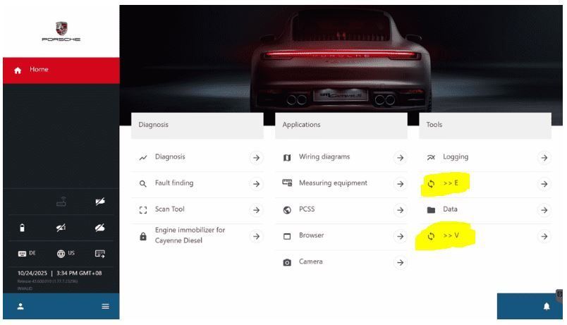

Old PIWIS III software I got from ODBII.com online - also have a Virtual Machine copy of PIWIS III - both do not work on the 992, but do work on my 981. New copy of PIWIS 4 (which also has a copy of PIWIS 3) I got from CarToolDeals.com
Main issue I see - the Russian PIWIS 4 tutorial online has a V and E mode under tools...
mine does not have that (it's listing as needing an update). I have a call out to the engineer on this...
One other thing I asked the engineer - getting an error on the VCI connect (though, I can connect and run diagnostics and reports)
