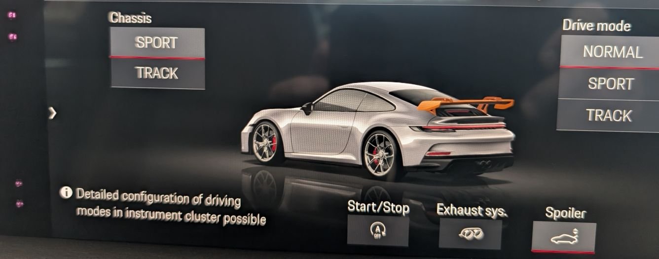

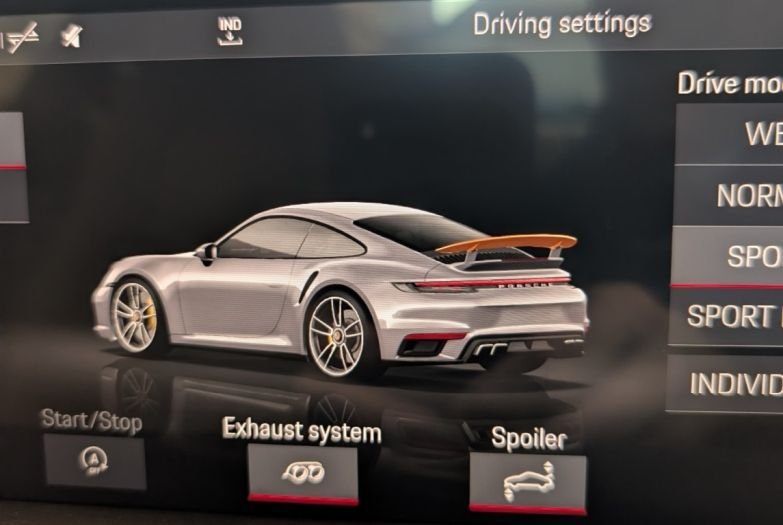

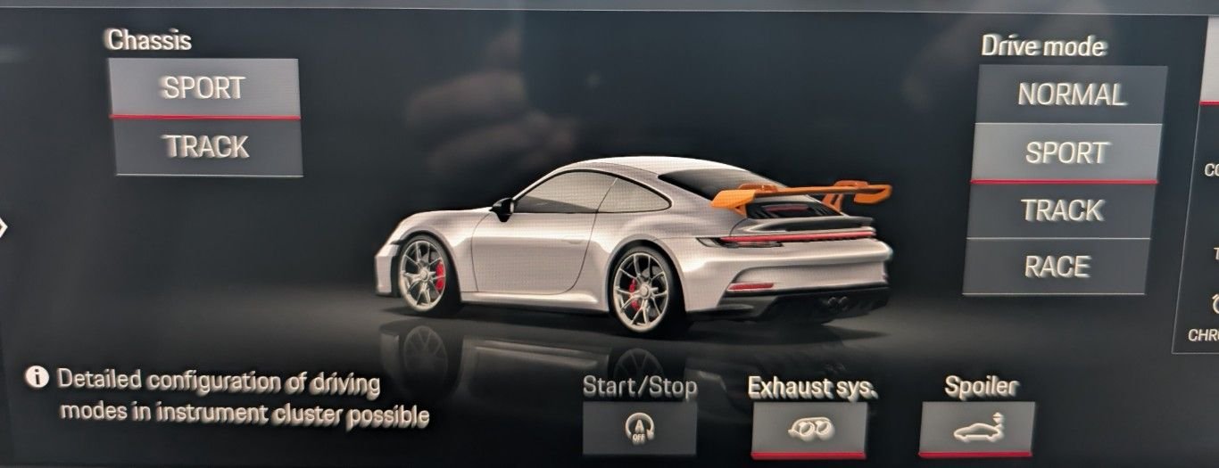

Originally Posted by Mr.Gonz
I made a fun little discovery today playing around with the wing positions for my turbo wing.
Under PCM in coding values, there are three value inputs towards the bottom:
By changing Derivate value from 4 (normal carrera image shown below) to 1,2,6,7, or 8 you get a Cayenne (everything functions as normal and the cayenne even has the same display changes when changing drive modes or enabling things like suspension or exhaust changes. No spoiler animation though lol.
Changing it to 5 yielded me a convertible carrera (not pictured). Can someone tell me what number will yield a Turbo S? I also tried to play with the 'skin' option but it didn't do anything afaik. Also not sure if car class has different values that unlock other models.
Can someone experiment here with PIWIS, I am using Autel and I'm sure PIWIS will provide more info / guidance.
ok @Mr.Gonz I think I may have discovered something ...
I played with the Derivate_Supplement value and tried 0 through 9. The table and images below show what I've found; the salmon coloured cells need further investigation. I've changed mine to the GT3 Touring in anticipation of my upcoming real lid mod!
Worth noting that changing the car in PCM doesn't show the same driving modes as the cluster but the cluster driving modes are still the correct ones.

Interesting. did the aerokit derivate_supplement actually show the aerokit wing?
