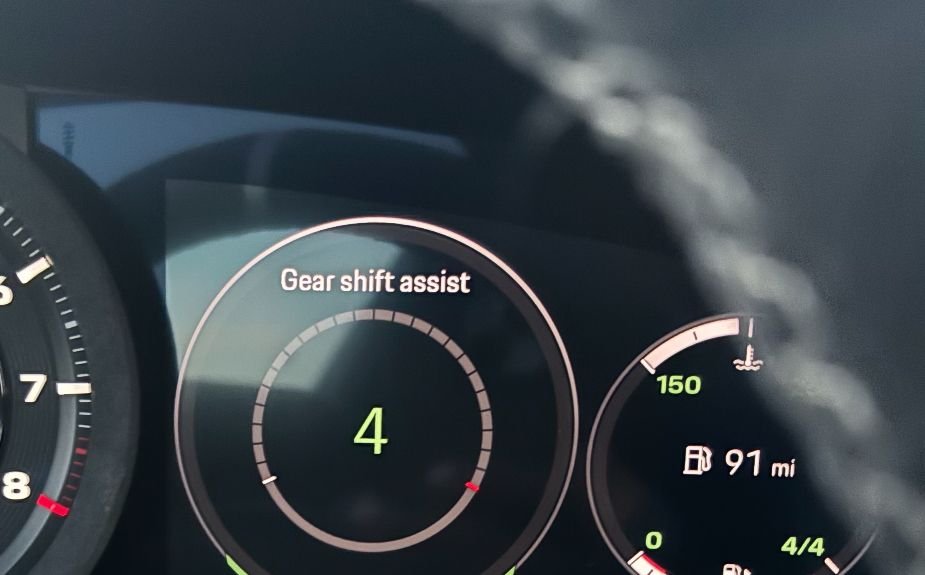

Mine's a 2020 model, but I do have a newer replacement cluster - perhaps that's why I see the Reduced Display option
no all car should be able to see it as long as you change it to GT3 or GT3 RS. what we don't see is the Tire temperature and I m trying to see if anyone can try it on the 22+ to see if the shift lighjt to work cause i been trying to figure out how to get that to work

Creo que te gustará. Incluso los números de la luz de cambio/revoluciones son verdes:
al elegir la opción Sport Classic, también se implementará la instrumentación verde.
Necesitarías codificar adicionalmente la aguja completa del velocímetro, etc.
And do you know what additional coding needs to be done?
In the more extensive coding thread there are instructions on implementing the full needle. I have a ‘22, so mine came with the full needle display.
