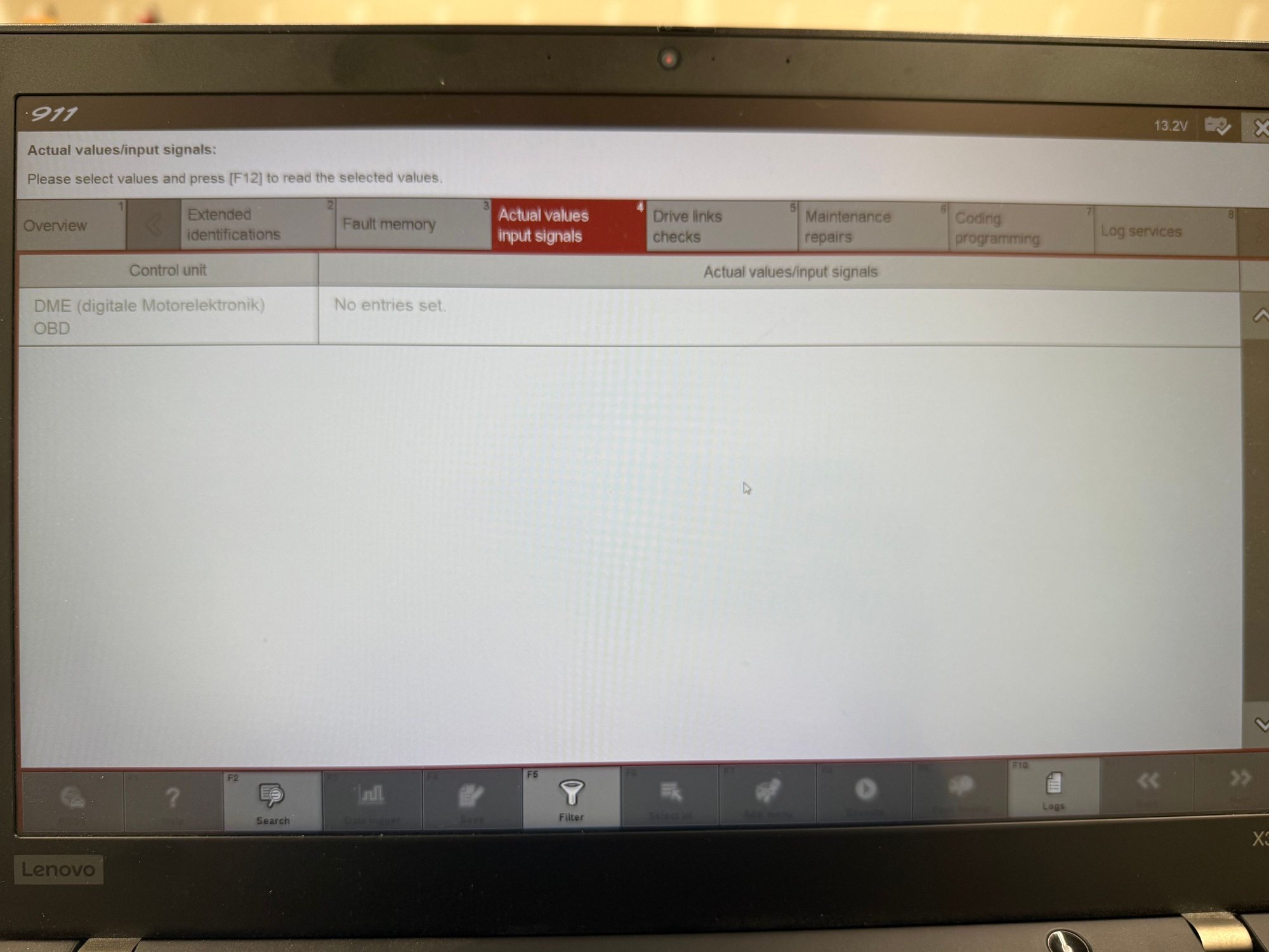

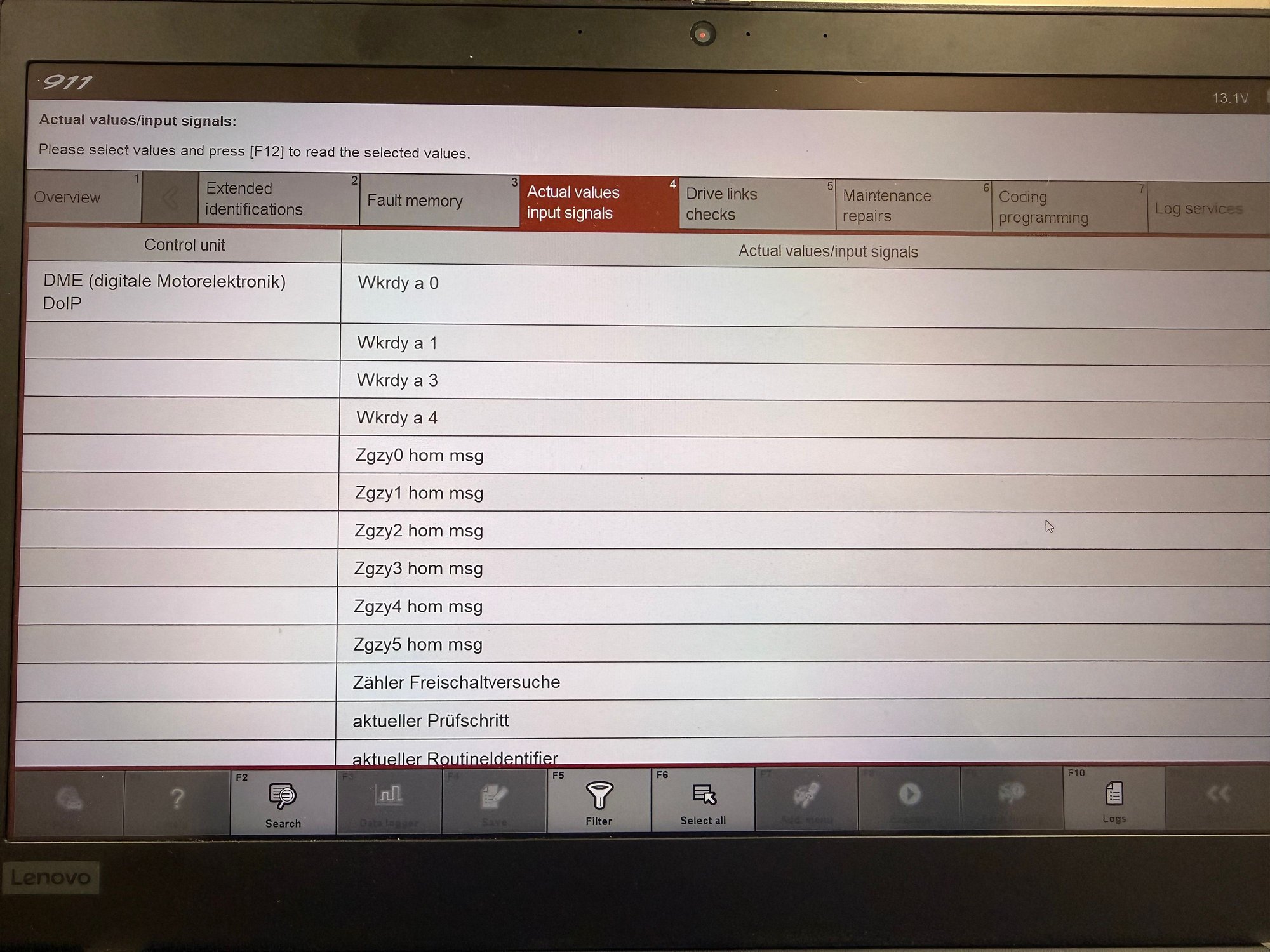

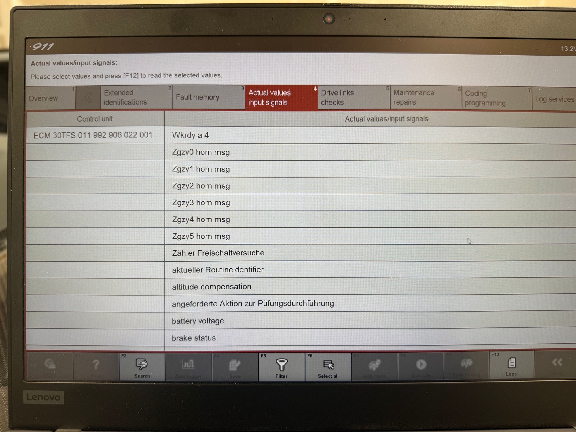

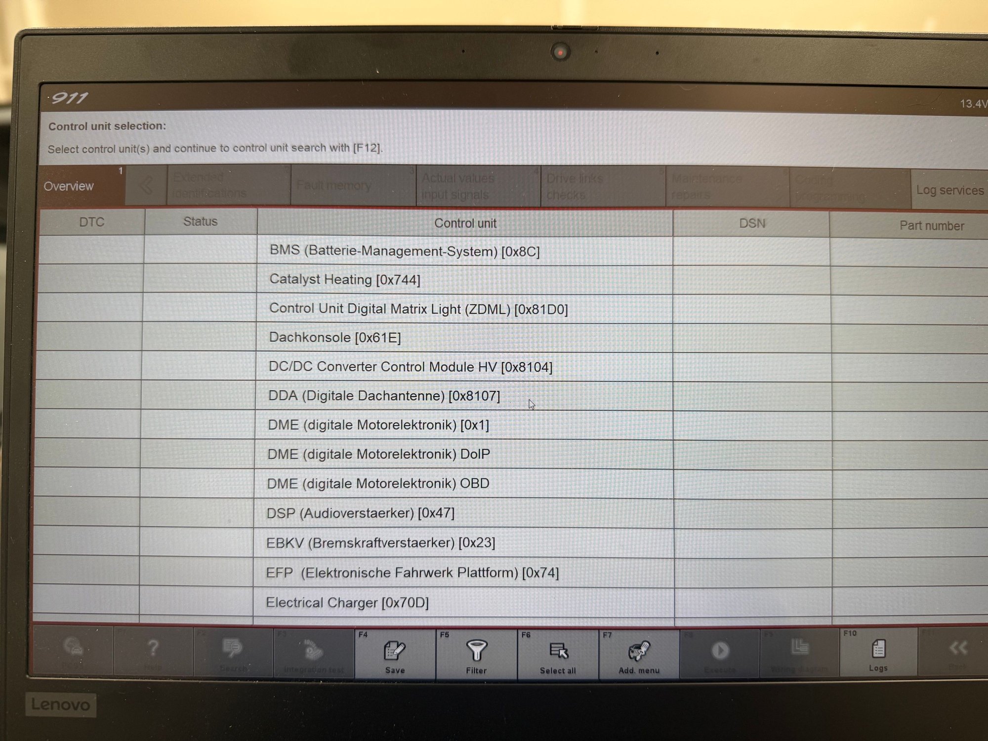

I have 3 entries for DME, and in the actual values tab, none of them have Z-Timing

Some funky values there. Are you clicking on 0x1? What version or where did you get your PIWIS from?

Finally figured it out:
Change to Standard “V” mode in the PIWIS 3 main menu under Tools
Diagnostics -> Diagnostics -> Engine electronics (DME) [0x1] -> Actual values input signals -> Z_Timing angle -> Next/F12 -> Z211/Z212/Z213 for number of ignitions and operating hours -> Next/F12
