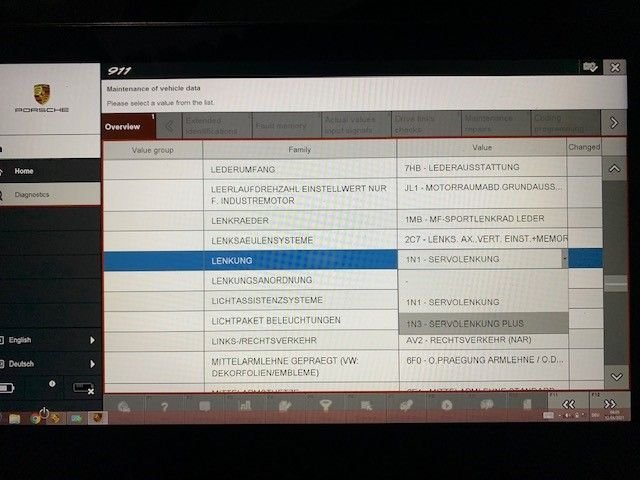

I figured out how to code power steering plus. In the additional menu by F7, there is item for power steering (in German), choose power steering plus, save it by F8, then you have to adapt the coding by going back to list of control units, select all by Ctrl A, then coding program, select automatic coding and wait, it will take 15 minutes to finish.
interestingly, it doesn't ask for activation code for this modification like other models, which is a few hundred dollars option. Suncoast sell this activation code for $299, including some MY 22 models, but not available for the 992. not sure if it will be added for 992 in the future. but for now, it is free if you know how to do it.

On my post from sept 21st I took a pic of the steering sensitivity options. It actually made a difference while driving. I tried superdirekt TOP in my last coding session but it failed to write to the module. On that module you can also Che Che the brake booster, default is medium. That's likely where GT cars will differ in that are as it's an electric brake booster rather than mechanic.

What does the power steering plus give you over regular PS? Do you have to auto code all modules?

That's what liked most about this, single line.
It makes the steering more direct, not really heavier, specially with sport and sport+. If I recall correctly, normal, sport and sport+ don't have a great deal of variance on steering feel.

Sorry, drop down option. No need to code multiple modules.
It doesn't work that way. after choose the power steering plus, you can "save" the value by F8, now the data will be changed to "plus" now if you go back and check, but the steering effort remain unchanged when I tested drive.
after I went back and applied the "adapt coding procedure", then the effect finally kicked in.
power steering plus makes steering easier at low speed, so you need less effort with parking. some likes it. I prefer it.
