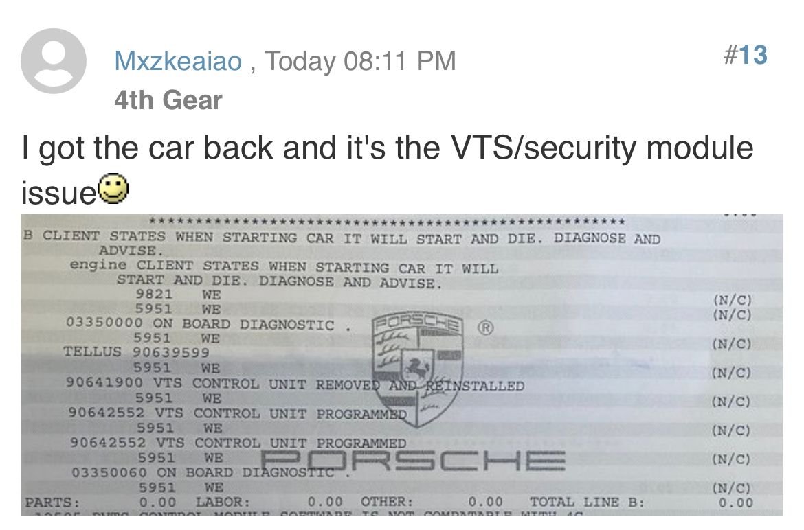

Originally Posted by B Russ
asellus, while your willing to stand hard on whats NOT causing this failure your not willing to say what is
Yeah, that's usually how diagnosis works. Given the limited data we have, as well as possessing a modicum of common sense and sanity, I can make the statements I have made.
I've actually listed numerous things that it could be. In light of the recent post here, add "another software glitch" to the list if I haven't already said that.
Unit removed and reinstalled ??
R&R is typically combined into a line item. Keep reading, the next line is "unit reprogrammed" which could have been done on the bench, or in the car. Or both, there are two entries.
