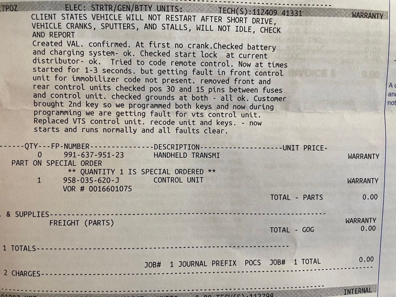

Update: got my car back today, and spoke to the technician who worked on the car. Unfortunately, I didn't get any information that will shed much light here.
He said that based on his experience, the VTS unit failing is rare. He said that the car operating depended on communication between the keys and the VTS unit, and usually it's the key that fails, not the VTS unit.
I asked him if he thought it had anything to do with the 3G sunset, and while dismissive of "theories floating around the internet", he couldn't say whether it was related or not. For starters, he said he has no idea whether the unit even communicates with the network without the subscription to the tracking and car connect services. He did say he's seen these units fail on older cars, before they had any cellular connectivity. But again, it's rare.
If what he said is true about the VTS failures being rare, seems like "something" is happening here given the spike in reports we're hearing about. Not saying that "something" is the 3G sunsetting, but a spike in failures for a part that rarely fails seems at the very least to point to something beyond just a part failure, especially for cars that are relatively new.
I asked him which unit the old one was replaced with, and he said it was replaced with the same 3G unit. He said in the 2019 Carrera, the 4G unit is not compatible. He also said the unit was replaced without having to remove the dash.
So whether this is simply a routine failure of a part or something triggered by a more systemic issue, we'll probably never know.
At this point I am just glad I can drive my car.

MichaelB, thanks for posting the invoice with the part number. I’ve sent it to my service advisor, I hope they can figure it out. Best driving days of the year minus the pollen…
