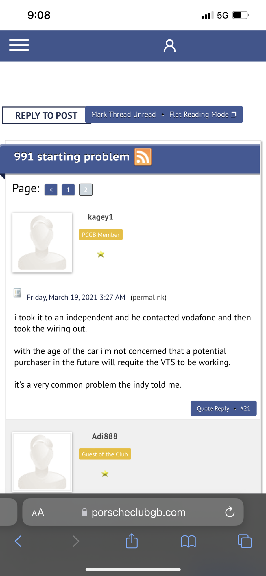

I did a quick search outside Rennslist. It looks like this goes back to 2012 from what I have found from other owners. I took a screen shot of how an owner had his Indy remove it. I don’t know if this applies or if it’s even possible, but could be worth looking into.
Here is a link to the one of the forums I have read:
https://www.porscheclubgb.com/forum/...063668&mpage=2

Hmmm ... is this particular device/capability something that should "simply" be removed? Would removal void the warranty on those cars under warranty? Would removal increase insurance costs?
Sure, there would be less security, but perhaps this is offset by more reliability, especially given Porsche's uncaring response both in parts and loaner cars?
Old May 19, 2022 | 09:22 AM
  #90
Porsche_nuts's Avatar
Porsche_nuts
Joined: Jan 2010
Posts: 6,136
Likes: 1,658
From: New York
I would think that if the solution could be as easy as just removal, they would have at least suggested it and leave it up to the customer as accept or deny such service. I would readily accept the removal solution rather than a disabled car during the height of the driving season.
