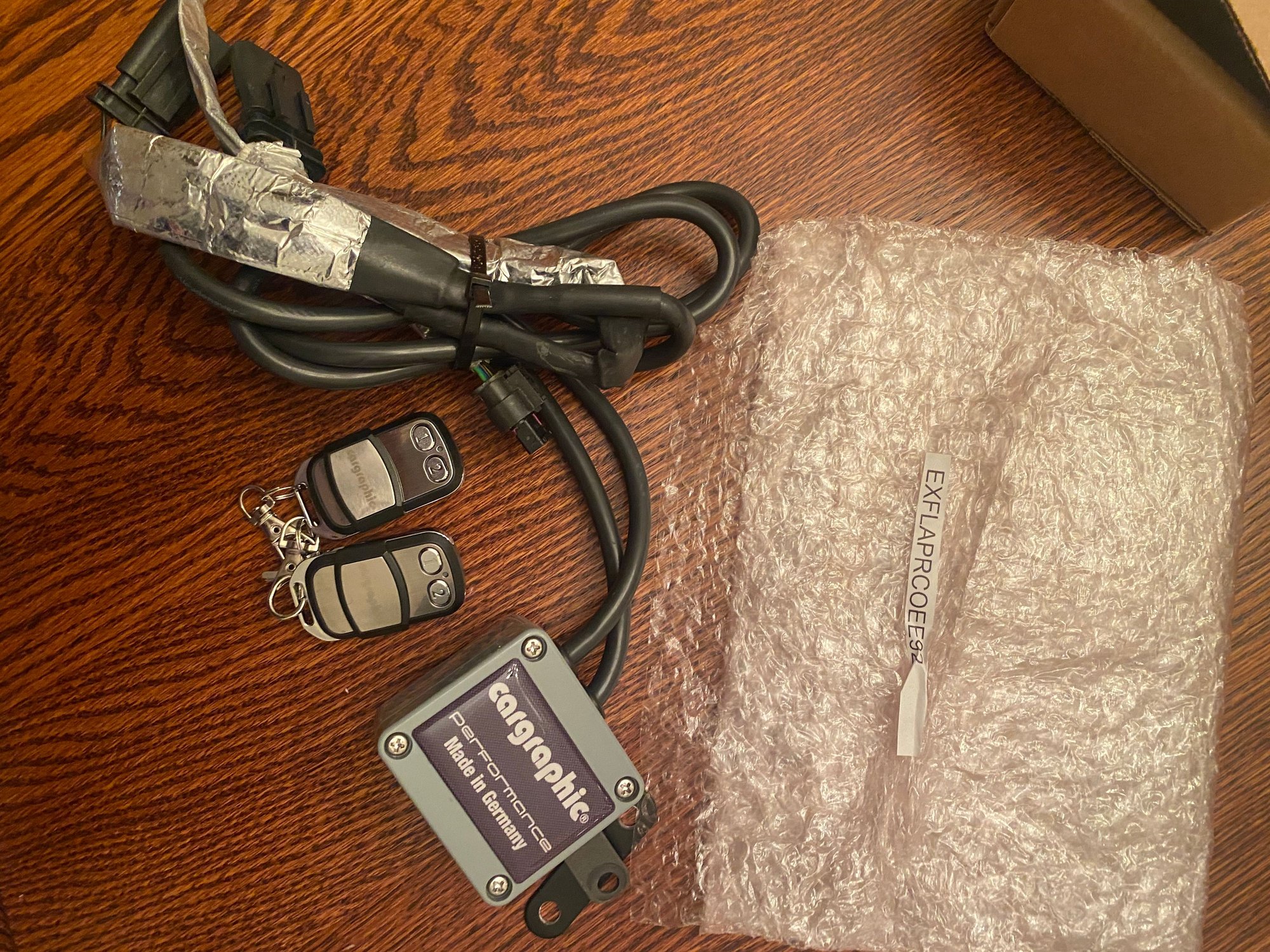

I have a cargraphic valve control for a 992 Porsche for sale. $400. I put a tune on and no longer need. It’s like new.
Great price and highly recommended, especially for those who are not doing a tune.
