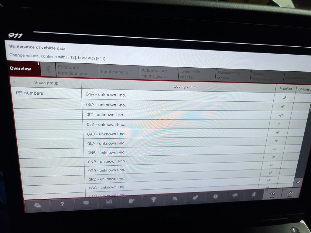

Originally Posted by Porschetuner2005
In a nutshell, this is how you do it....Make sure your are in E mode on your tester:
- Once booted, go to the bottom of the screen to Additional Menu (F7)
- You should see this screen:
- Select the highlighted option and continue....
- Keep hitting F12 to scroll through the first couple screens till your get to PR options. If sorted alphabetically, you care looking for the option "CW Wert Verkleidung" and the option selected should be something like 2D1 or 2D9.
- You want to change your 2D9 option to "VM3 - Aerokit"
- Once that is done, keep hitting F12 to move through the screens till you get to this one:
- This is the final confirmation of what you want to change. Hit Save at the bottom or F8, then it'll be F12 to exit once that is finished.
- Lastly, go back to main menu showing all your modules
- Ctrl + A selects all modules, then go to Coding/ Programming
- Select Auto code, then F12 to start
Once that is all complete you should be able to clear any faults and be good to go!
Keep us posted!
Is this the same process for changing the active aero on a C2S to an Aerokit fixed wing (OEM). And will this take care of the spoiler errors and the 3rd brake light error too, or just the spoiler. Hoping both as the 3rd brake light will not be an issue with the Aerokit now coded.
You code each issue separately, but it’s quick.
Today @kilyung came by and we tried to use his PIWIS to code the spoiler. Got the below error message when we got to the save function.
“The vehicle data could not be created. 29000: Negative control unit response: Security access denied (7f 2e 33)”
Old Jun 21, 2025 | 07:19 PM
  #855
M3Inline6's Avatar
M3Inline6
Joined: May 2021
Posts: 8,365
Likes: 7,025
@f4bones
Any insight?
