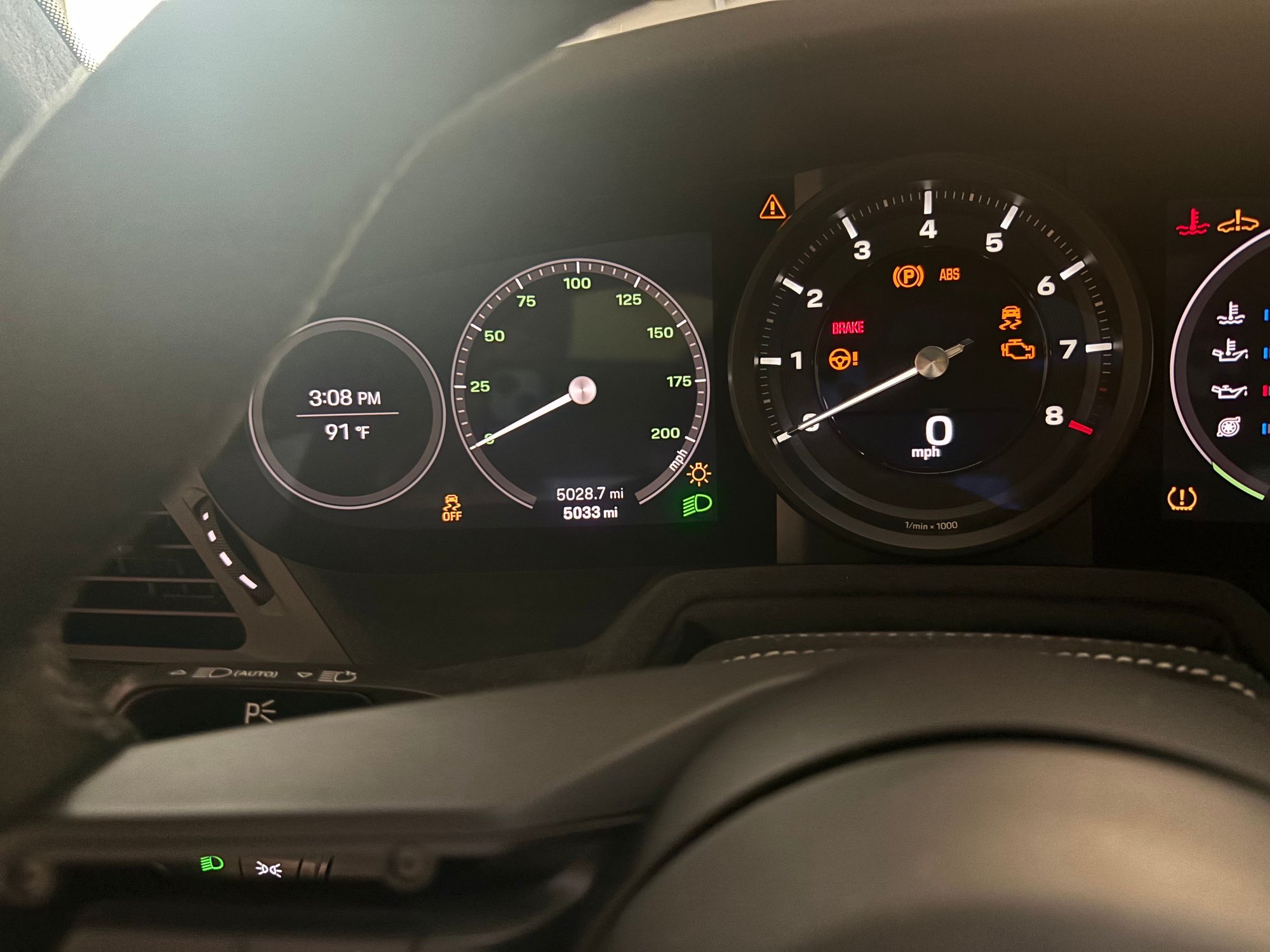

Originally Posted by fossilfuel
Hi guys! I have tried to read through all 55 pages of this thread.... but I get lost (I think personally coding with PWIS is above my skill level). So forgive me if this has already been asked/answered.
I have a 2021 992.1 Targa 4s.
1) Can the illumination of the numbers on instrument gauges (physical tach and screen for the others) be changed from white to green (Heritage gauge style). I have a white tach and black sport chrono and I would like to change to guagefaces.com heritage style faces, but would like to change the numeral colors to match (see pics of what I have and what i am trying to get to (from another members pic).
2) My speedometer gauge (immediate left of the tach) only has two display settings when i select that gauge and roll the wheel to change images: Speedo only WITH NOT FULL NEEDLE, JUST THE TIP* OR Nav instructions (again see pics). On another thread on this members suggested that the FULL NEEDLE view was a 21 ---> 22 change and that *maybe* it could be coded in. CAN IT?
3) Probably related to #2 above, I also do not have (or cant find) the option to switch from 5 guage display to 3 gauge display. It was suggested that is might also be a code-able 21 ---> 22 change?
if any of the answers are yes..... there is beer, coffee, bbq in it for anyone in austin who has a PWIS and will help me code them
Thanks in advance
-mark
* I can already hear the bad just the tip jokes!
Another Rennlisters Heritage gauges....note the green numbers on the perimeter of the tach, speedo, clock and temp/fuel gauges.  Can i get this on my non-heritage 2021 992.1?
Another Rennlister's very sexy Heritage gauges....note the green numbers on the perimeter of the tach, speedo, clock and temp/fuel gauges. Can i get this on my non-heritage 2021 992.1?
My car... White Tach, middle left gauge
My car middle left gauge in speedo only mode---note NOT full needle
My car, middle left gauge in NAV mode
The answer to your question(s) is yes and no.
Yes, you can change the illumination of the numbers from white to green, but in order to do that, you have to go into KOMBI and change the dash splash screen to Sport Classic, 911 S/T, etc. I did it on my own car, but the drawback to that is the model designation will not be accurate for your car. Whenever you turn on the car, it’ll show whatever model designation you chose to achieve the green illumination.
No, you can’t change the center tach to a heritage style tach without taking the cluster apart. That juice will likely not be worth the squeeze if you aren’t mechanically inclined.
