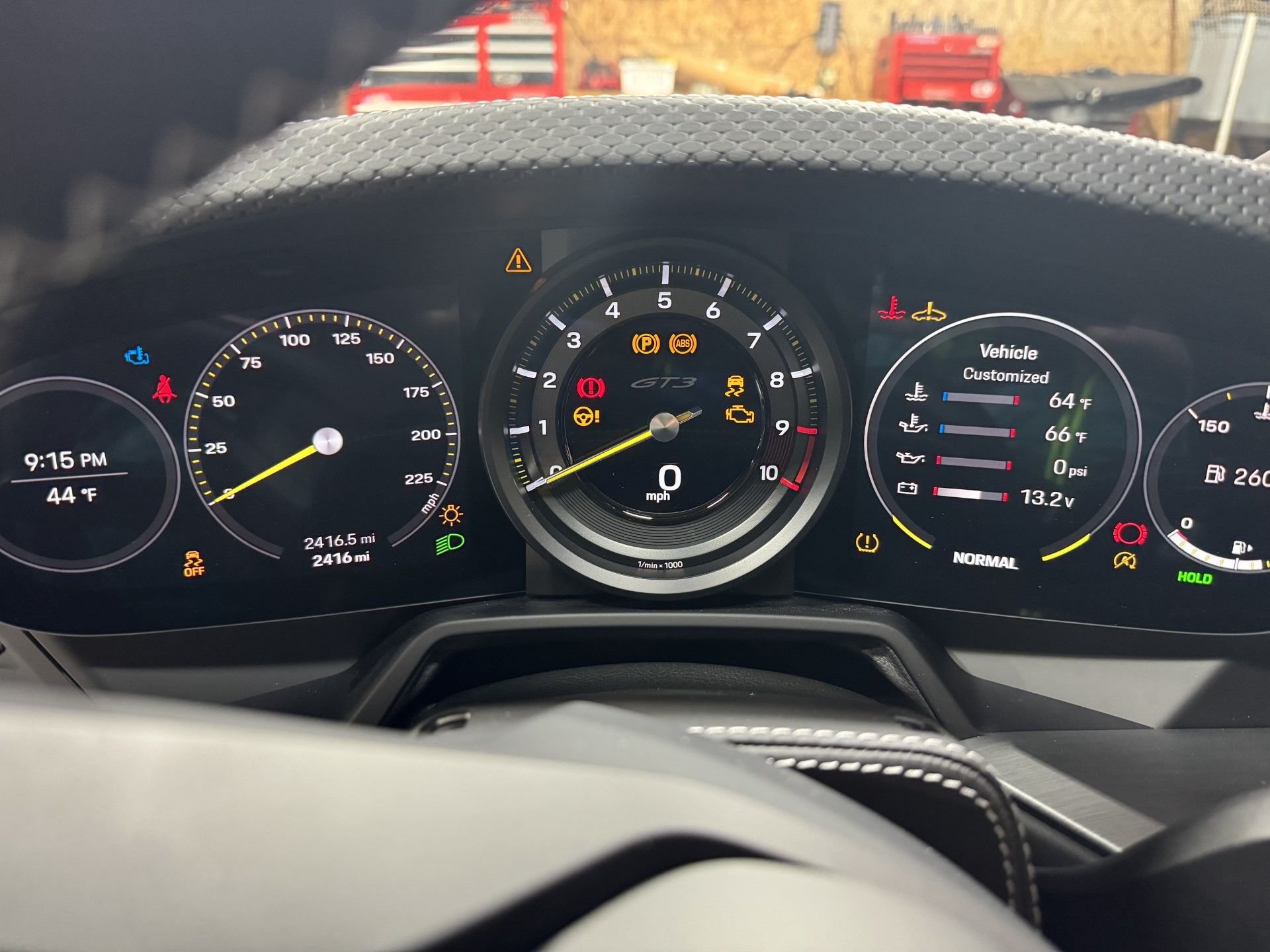

Victory! My Canadian 992 GT3 now is coded for Fahrenheit and MPH/MPG. I am in the states, and this is a huge help. A big thank you to rnlst_log here on Rennlist!
