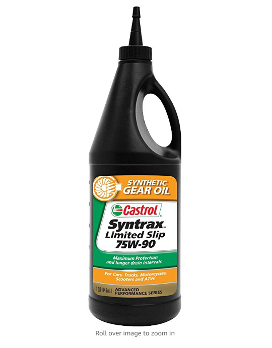

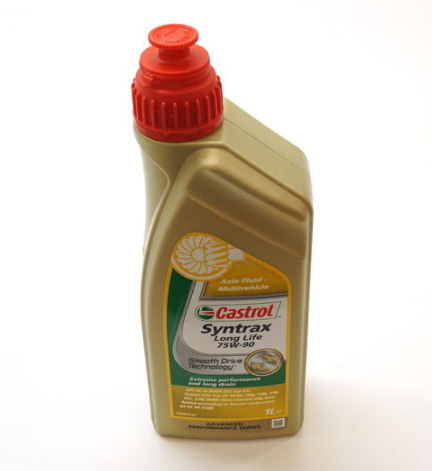

Originally Posted by Quadcammer
Castrol Syntrax 75w90 seems to be a useable alternative to factory product
I questioned this because just the name itself is too broad. There are many products with the same general name, so I didn't want to add to any confusion and instead wanted to know exactly what needed to be used.
Googing that name gets you something like this (which is wrong):
And this is the correct one:
I'd read in this thread, or maybe another, where someone had put the wrong fluid in, and ran it for some time before realizing it, and having to change it out again, so just making sure I'm clear as possible if I'm going to share information with the community.
