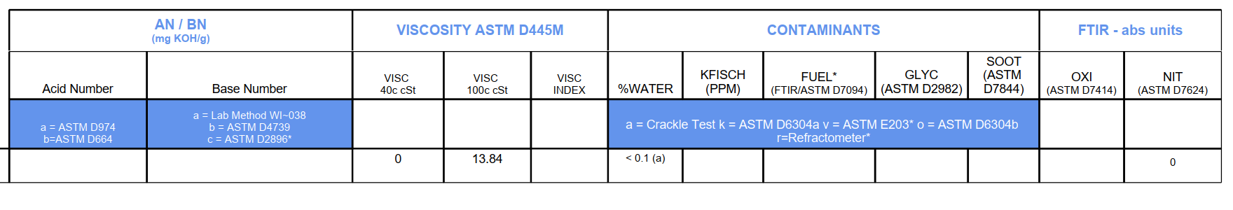

I sent mine in for analysis before I regear my transmission so I have a little bit of a baseline with the 4.00 R/P:
2800 miles on the oil and a bunch of autocross laps (>150) on it.

Thanks so much! This is exactly what I needed to know and our Iron levels are very close to one another.
I may change trans fluid again this year and if I do, I may send it to the same place you did just to get similar data.
Excited to see how the internal of your trans looks too when you regear it. Will be following in your other thread.

No problem. Do you mind posting yours as well? I’m curious and it might be nice for me to have more than 1 data point.

ngng, do you have any UOAs of your Motul? I was curious to see how much shearing you got after a year. Mine showed a ~0.4cst change after 2 years.
