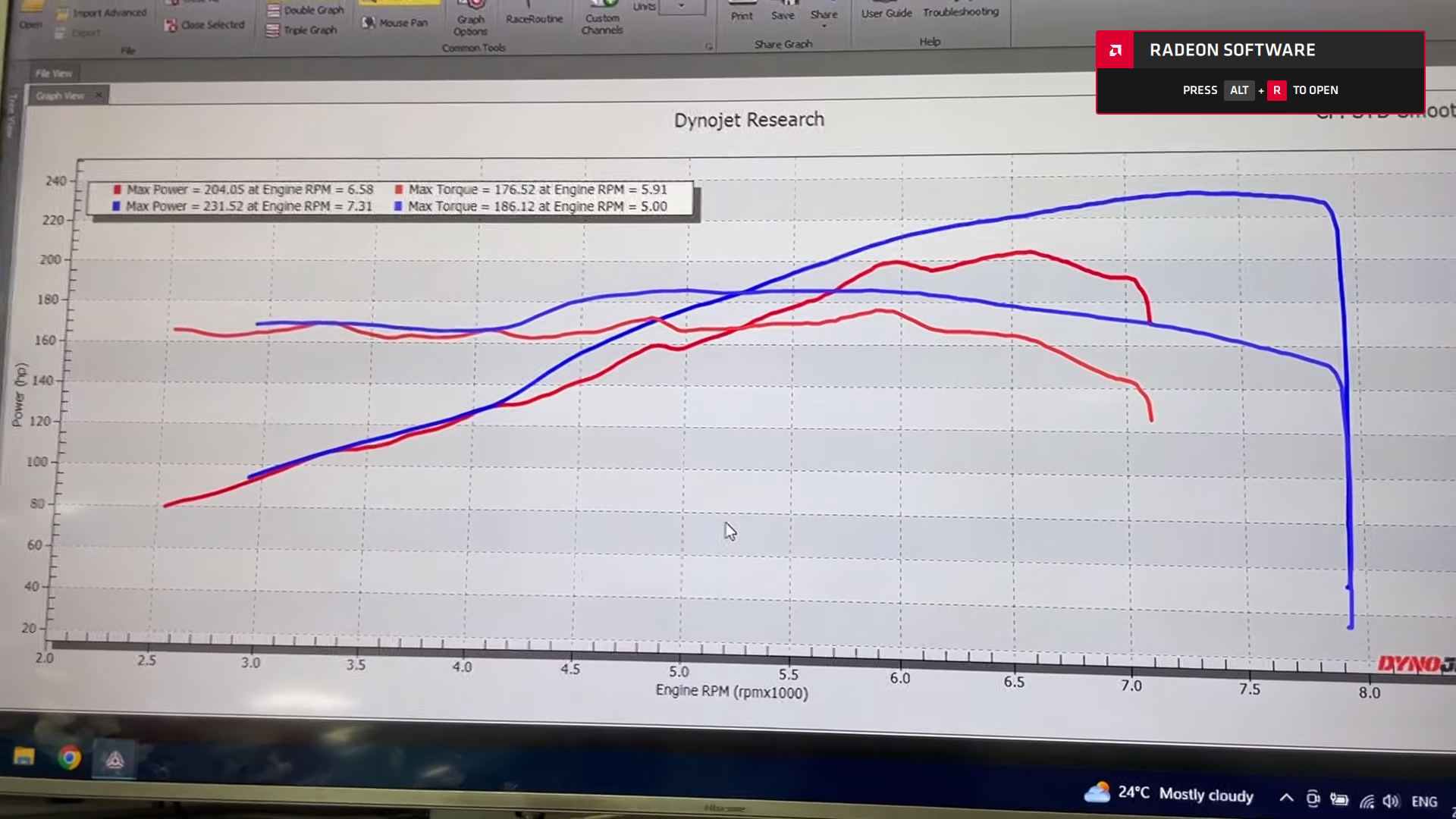

Subbed, I'm really interested in these swaps. Though my application would be a bit different, as I'm (im)patiently waiting for Nick to do the Boxter/Cayman version. I have a 99 Base Boxster and let me tell you, there is NOTHING SPECIAL about that engine. It's fine, it's okay, it's nearly adequate for a grocery getter. Uh, the intake noise is nice! But it is not special. It runs, and maybe someone would like to purchase it when I remove it to swap in a K. My original plan was to buy two motors, slap one in the car without opening it up with a very mild turbo setup, while I do a minor rebuild (rods and gap the rings should be good for 500 whp reliably), and save up for a built transmission. But after seeing that first graph, I might skip the intermediate turbo set up altogether, and just run it NA for a little while before putting the lightly built motor in.
Here's a question, I keep hearing (even in this very thread) that the K will be low torque, not as good on the street, peaky. Also, in the same breath talk about how great NA engines are, especially when you can keep the revs up high. Which one is it? The "low torque" turbo application sucks because the revs have to be kept high, or the NA application is great because you have to keep the revs high?
Here's a dyno graph from one of Nick's videos overlaying a stock 986 2.7 L 240 hp (PURITY!!!!) Porsche engine and a stock, Naturally Aspirated K24. Would someone please point to the part of the graph where the K has drivability issues, low torque, no low-down power, or for that matter a peaky, unusable powerband? I do see at least 1500 RPM of 'more fun' at the top end and the area under the curve is massively different, so it wouldn't be hard to guess which one would win in a drag race, all else equal (which they aren't since the K and trans combo is quite a bit lighter).

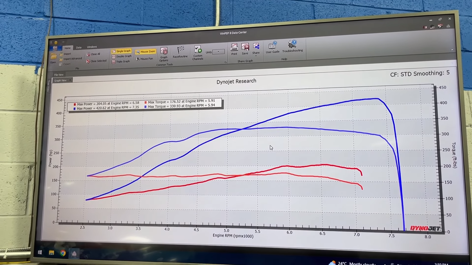

Here's a K24 at 11 psi with the 2.7 overlay (underlay, I guess). To me it looks like it's a very linear curve that climbs and climbs and climbs in power until you shift. Isn't that what you want in a sports car?
