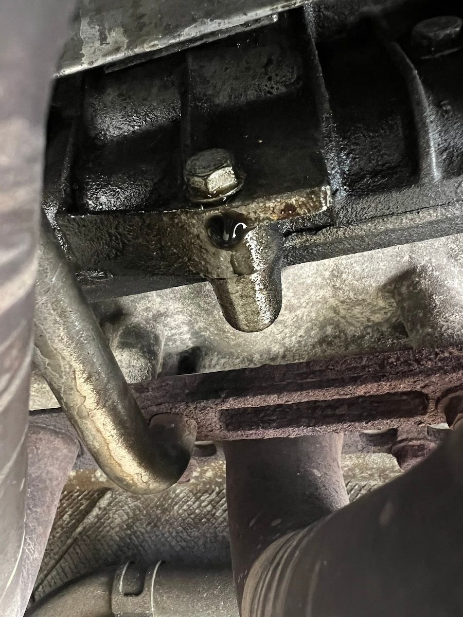

You have found your Culprit !!!
LIke I said, a drop of oil every few seconds is all it takes to make a lot of smoke on full throttle when that oil hits a red hot exhaust....
This would make a good Technical PSA Thread.......It's happened many times before and will in the future.. And many will go down the wrong Rabbit Hole......lol
Originally Posted by Ben8jam
Well, funnily enough, I went out yesterday and checked and for the first time ever, there is a single drop of oil on the driver's side coming from plugs 'area'. I had cleaned the area behind the heat shield pretty well when i first got the car, so will check behind it again this weekend. Guess new tubes are in order... and investigate the valve cover more. Will check the exhaust too to confirm spotting. Thanks for your quick insights!

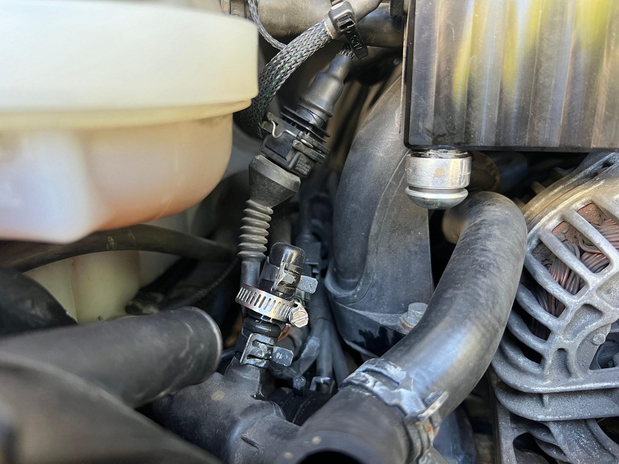

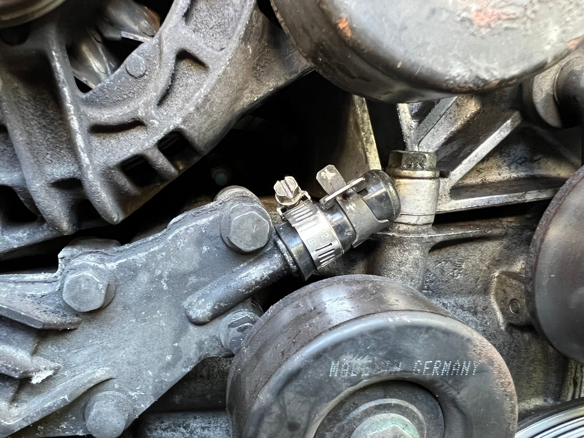

I did the crossover coolant hose delete (the one my indy inadvertently added when installing the UAOS). Anything I should confirm before testing?
I clamped down the little rubber caps on the metal host outlet on the block and the little plastic connector from pipe under reservoir. Coolant pressure won't pop those off right?

Nope, they are high quality Silicone Rubber caps.

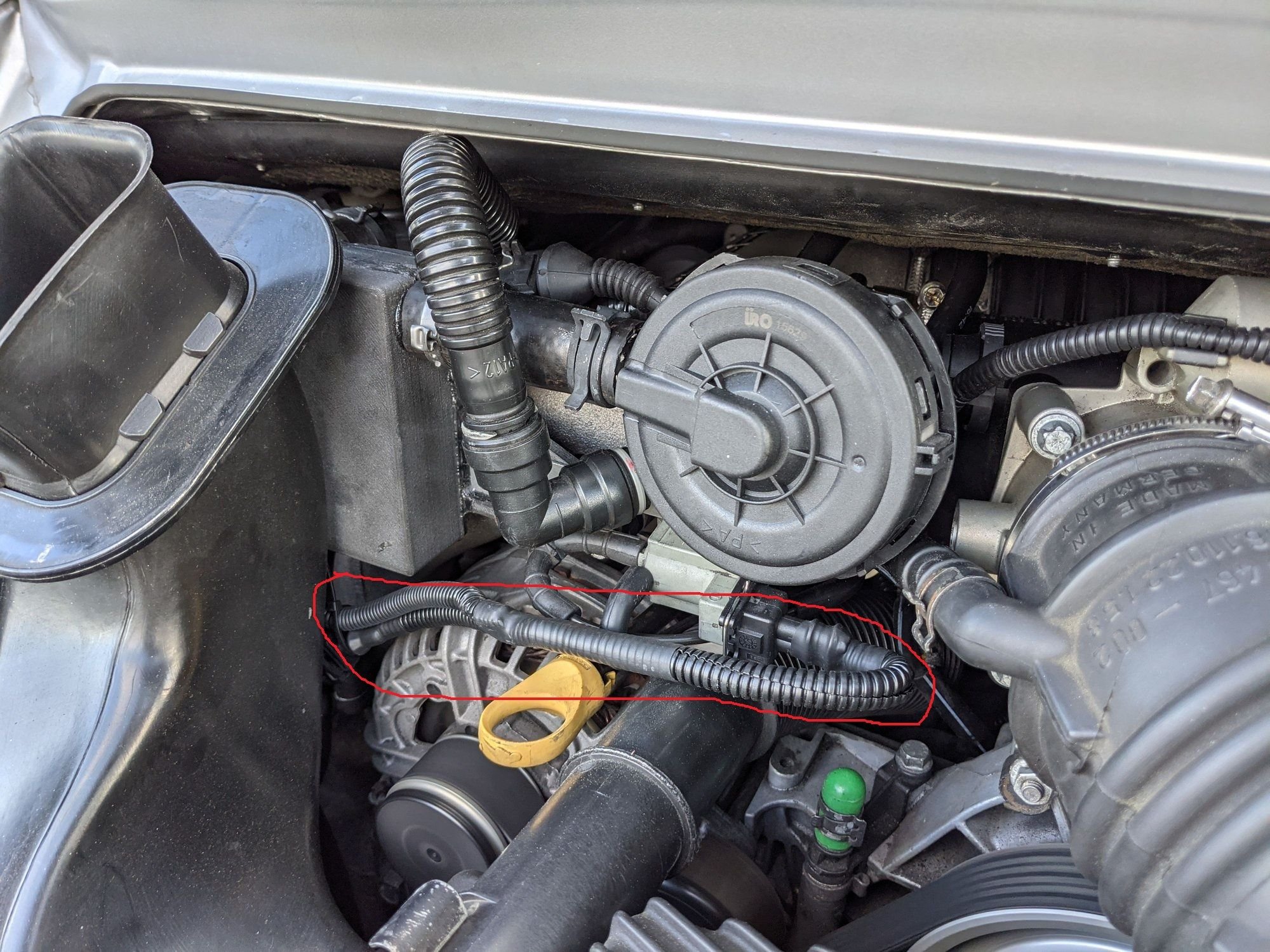

Hi all, I am just installing the UAOS on my 40th AE. I am pretty much following @plpete84 manual and what confuses me is the wiring going to the changeover valve that plpete84 has on his pic below. It looks like some kind of wiring extension which would be useful to have but my UAOS kit ordered here in Europe came without it. It makes wonder if miss this extension or not. Thanks and warm greetings from the Czech Republic to everyone!

That's not an extension but rather the Sensor/wiring harness itself ......
If you look at your harness you will notice the two big connectors are far apart to accommodate the re-location of the change-over valve

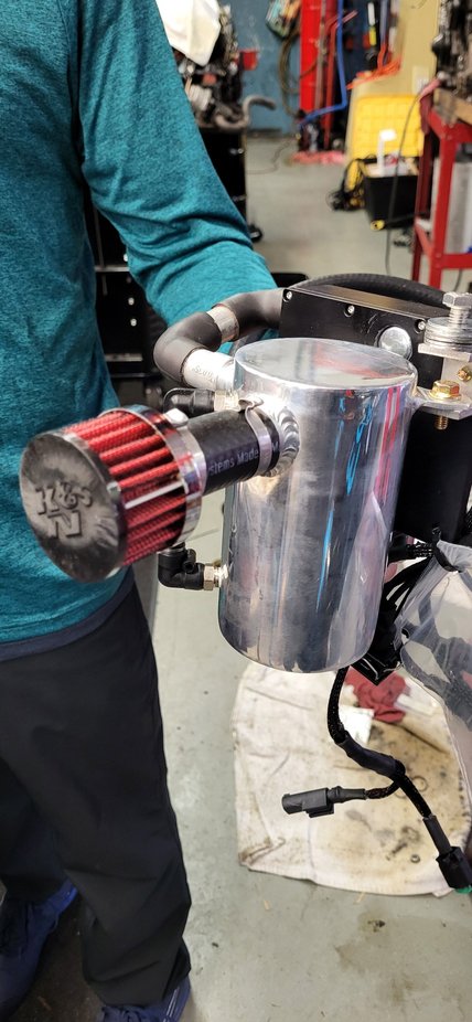

Thought everybody would find this of interest.
I was just at my indy (Eurosport) last week and one of the techs said take a look at this. He held up the RACE version of the UAOS which is not emissions compliant for the street, but instead is designed only for the track.
Skip has talked about it breifly here on Rennlist, but i had never seen it. Hopefully Skip will share more info about it. Pretty damn impressive.
Good to see the recognition and demand growing with Porsche Indies that support the PCA club racing, track and street only community about your three (3) UAOS solutions. You have three flavors depending on what you are looking for.

Wow...thanks for posting. Is the street legal track drain version able to be retro fitted? I only have a couple hundred miles on mine, but the car is registered in MT now, so i could technically do anything to the engine 😂
Curious either way how the track only version works/differs.

I have the track drain version. I think there is yet another, non-street emission compliant UAOS, which that photo is of. Looking at details on that.

3:: Race/Track Only Option
This is NOT emission Legal and is NOT recommended for Street Cars...
It can be retrofitted to any UAOS System but is not recommend for street cars because it eliminates the recirculation of the Blow-by gases to the engine...The recirculation of the Blow-by gases actually helps to keep the oil cleaner for longer periods for Street Driven Cars...On Race Only cars the oil is changed after every Race or Track Weekend so is not a problem. Because the recirculation puts the Crankcase under a slight vacuum which helps keep the contaminates from the oil ...
Also when the recirculation is eliminated the engine will run slightly richer during cruise, this is not a problem for Track Only/Race Only Cars as they don't spend any time at cruise. They spend most of the time at full throttle ...But this would be an issue for a Street Driven car to run slightly richer at cruise and effect the fuel trims ..
The Race/Track Only Option includes an additional Aluminum Polished Accumulator with a small K&N air filter.. Custom Connection Hose and Intake block-off Norma V2Quick Connector ......
This Option provides the highest degree oil level and of protection for short periods only for a Race Car or a Track Car....
