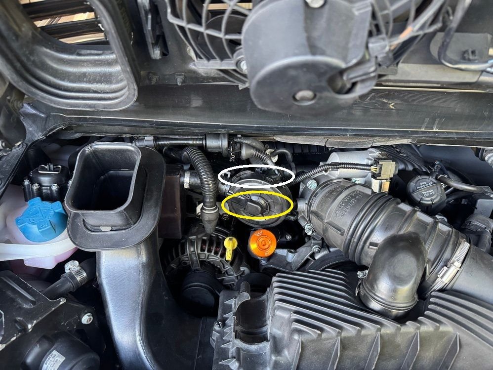

I've had the UAOS installed for a minute (on the engine) now, but just now getting the motor back in the car. Tried closing the boot lid and the and it seems like the back of the fan motor housing is impacting the round bit of the UAOS. Do i need to trim the hoses or did I get something installed out of order?

Loosen the spring clamp on the diaphragm and rotate the diaphragm from the yellow position to the white position...the release the spring clamp..
To clarify.... Face B(the diaphram) should be rotated around Hose A, so that face B points up? (as compared to as pictured, where it faces the back of the car)
Or are you saying that face B is pointed the correct way, it just physically needs to be higher (but still facing backwards)?
The hoses (Hose A), and Hose C (unpictured, but back of the diaphragm to the throttle body) proscribe the range of motion possible. Just to verify, that should be a straight hose, about 3"s long correct? No bends or anything in the hose itself?

Yes, the diaphragm Face B as you denoted should be higher up to clear the deck lid fan...
The 19mm 3/4 rubber hose from the Accumulator to the diaphragm should be straight ...( it is a bit flexible and comes in a curled roll , but the desired position is straight and can be achieved if oriented correctly by loosening and rotating the hose to diaphragm connection )
