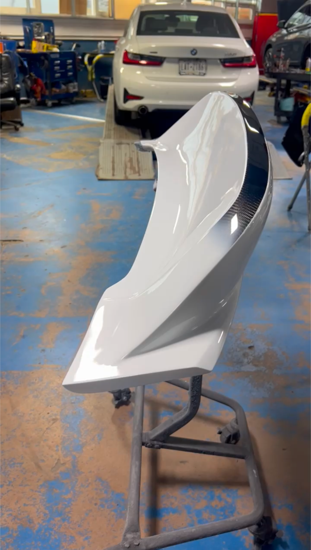

Quick picture. I will take more detailed pictures later. Adding new wheels tomorrow 😁

Looks great dude!
I like how the vent compliments the side vents on the bumper.
Any pricing info?

Thanks I posted the link from eBay in the earlier post. It was around $500-600.
