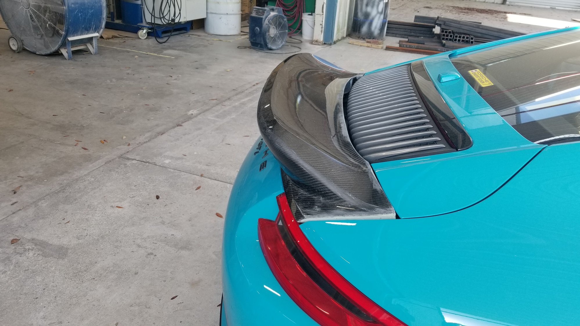

Ducktail update. Development prototype
Develpoment Ducktail
Ducktail is on the car! Have done initial pre/post intercooler temp readings and there seems to be a small improvement in intercooler efficiency! It was a coolish day so am waiting for a warmer day to do another run. Changes are being made to the mold for the production of the Production prototype. Mounting is very easy.
To bring everyone up to speed: To mount, the motorized wing assembly is removed and disassembled to liberate the baseplate. The third brake light in the wing is moved to the Ducktail. A carbon fiber piece is mounted to the upper rear bumper cover screws which holds the rear mounts. Baseplate is put in place and then Ducktail is slid rearwards to engage mounts. Front of Ducktail is bolted to carbon fiber mounting plates attached to baseplate. A trip to dealer will be necessary to convince the car the motorized wing is no longer there but even with error message no problems with driving. My initial thought is additional grill will not be necessary but don't think fabbing one would be difficult at all if desired, will investigate.

Great progress!
From the picture, the fitment around the edges and seams is still very very rough. How will it be addressed?

Originally Posted by innout
Great progress!
Good observation. The mold is being modified to improve fit. The primary use of this one is airflow testing.

How are you measuring airflow and intercooler efficiency? Are you using the stock IAT sensor, temp probes before and/or after IC, or.....? Are stock temp readings taken with the spoiler up or down?
Another excellent question. I have put thermocouple sensors pre and post intercooler. Have taken reading with stock system in various configurations (up and down) and repeating with Ducktail. Waiting for a warmer day to do another run.
