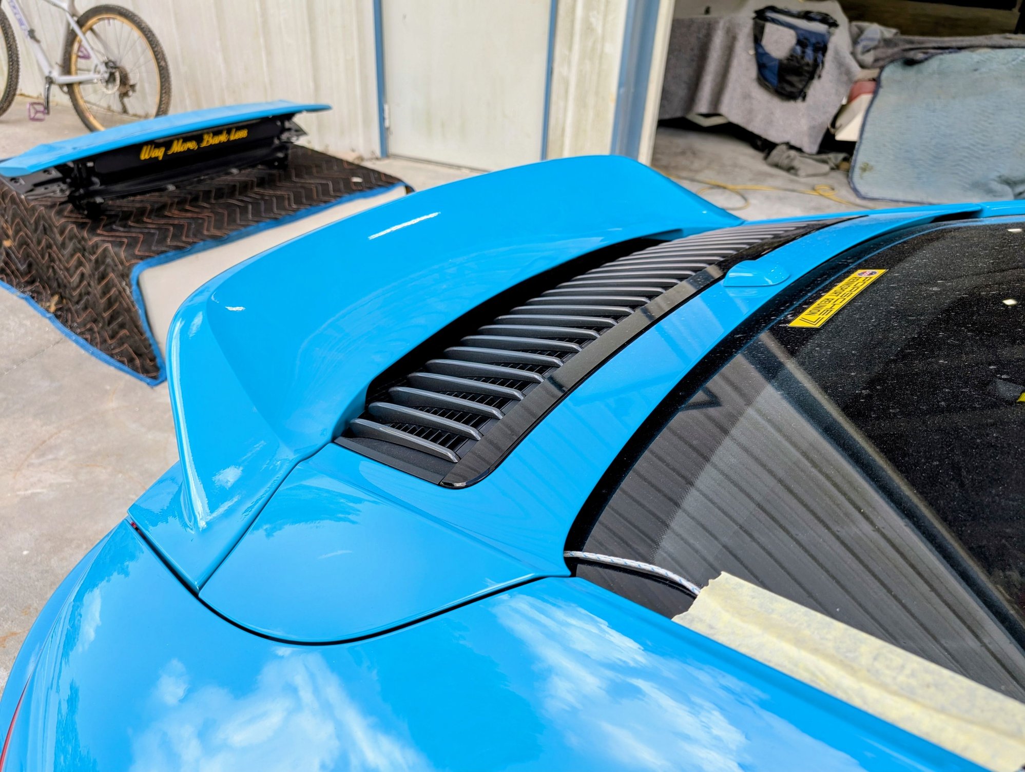

Default Latest update
Have modified internal ducting with a piece of neoprene to improve sealing. Now down to the last 10% necessary to get to a production item.
A bit of tape on right end of light
Modified front profile from 991.1
Modified front profile from 991.1 Wiring is from thermocouples pre and post intercooler. Good results so far and expect better with new seal.

That looks phenomenal for a prototype. There still are uneven fitments all around the lid. Mind sharing your plan for them? Also any update on the performance metrics? Thanks!
Plan is to produce gaps identical to factory product. Will be discussing changes necessary to mold profile with composites partner next week. No intercooler testing yet but soon. Other operating temps as normal.
Really appreciate everyone's patience.

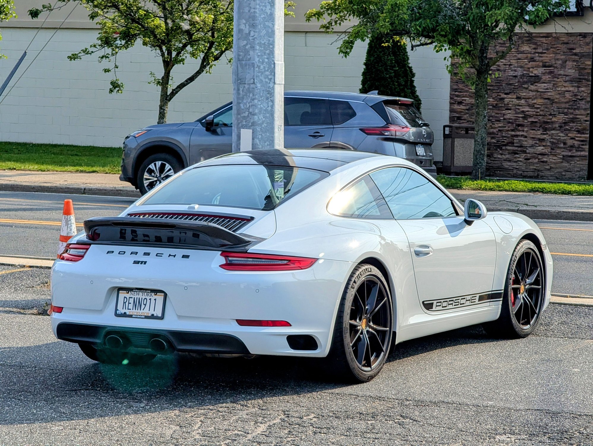

The ducktail arrived. It is full carbon fiber, super strong, and extremely light. Installation was simple, just plug and play. It goes up and down exactly like the normal wing. Loving the look. Now it is time for paint.
