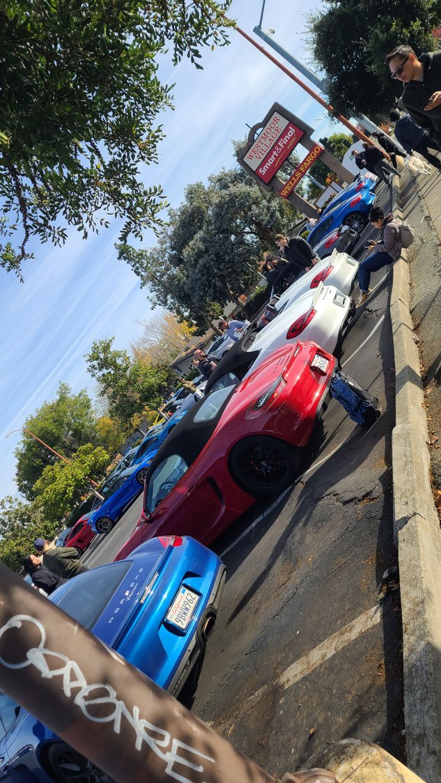

Did this mod as well as PTV activation on six 981 Cayman/Boxster today. I did two couple weeks ago. Most of them, so far are loving it.
I spy some Spyders. Did the GT3 calibration yield an improvement for them?
I didn't do it on that Spyder. There were like ten 981s at the meet this morning. Just the GTS, S and base models.
