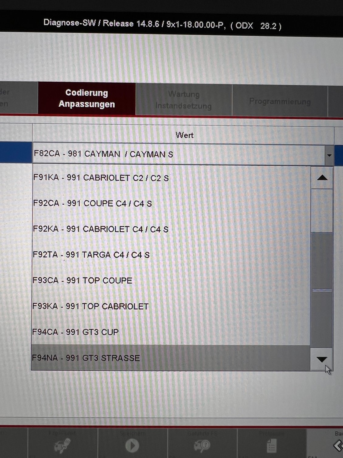

Originally Posted by DriverDaily
Its not an assumption. The first picture in this thread is a drop-down that lets you select the calibration based on the specific model.
Agreed. But "config exists" doesn't mean it's optimized in any way. If it is, then the question remains as to what the settings have been optimised for: The steering geometry? To the model line, which has to keep a distance to higher-priced models? On the customers to be expected?
Porsche felt the need to create different steering calibrations between the C2 991 and C4 991. Both of those are closer to the GT3 than the 981. [...]
It depends on what you are looking at. The entire front axle beam is identical on the 991 and 981. The wishbones are special for the GT3 but interchangeable. The damping does not show any differences that are not also possible within a/the model line - depending on the equipment (standard suspension / PASM / X73). etc. etc. etc. Well, surprise, surprise: The steering rack is identical, too. So those Carreras maybe "closer" in terms of model line, but they are not in terms of technical base of the front axle. Compared with the C2(S) the C4(S) has an additional front axis drive shaft for the steering which, according to Evo magazine, improves steering feel and performance (2m56s onwards in the video) - but that was just a guess in the vid as far as I understood it:
Anyhow: The only real differences I could feel from the more or less "numb" 991/981 steering was the upgraded 991 Turbo and the GT3 (both of which have rear-axle steering, and which I originally attributed the differences to). But maybe that's a European thing. I don't know, how those cars were equipped (software side) in the US.

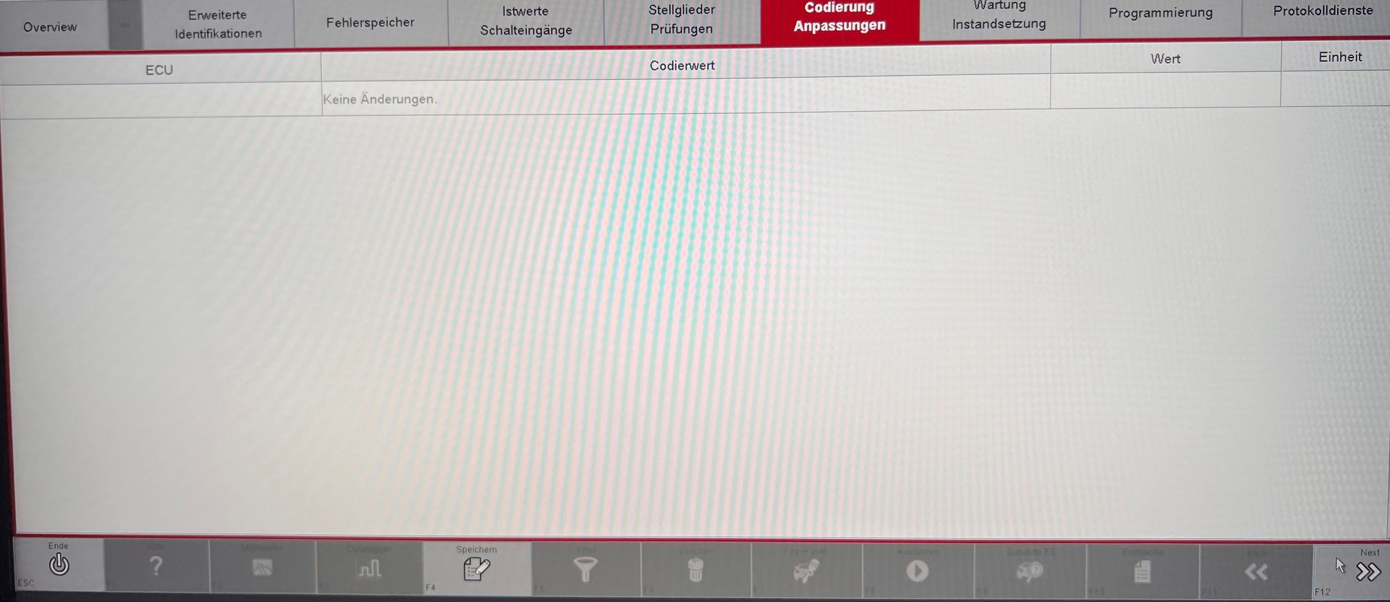

I found the menu in question:
I went for a spin and I couldn't really tell a difference between 'Strasse' and 'Cup'. I even switched back to stock for a few minutes but was quickly reminded why I never looked back. I was wondering if I was missing something so I dug a bit deeper:
Switching between 'Strasse' & 'Cup' generates this message, which translates to "no changes". So it seems like the steering rack coding between a "regular" GT3 and a GT3 cup car are the same, at least with PIWIS 2.

If I go from GT3 Strasse to GT3 Cup, I receive the same "no changes" message. However, if I go from the stock file to GT3 Cup, I get a message that reads "Coding value: Coding of vehicle classes" = "GT3." It appears that if the vehicle is already coded as a GT3 class, it does not detect any changes and therefore does not try to write any new coding. You could try to code back to the stock file using both manual coding menus and then try the process again using just the "manual coding" menu.
Also, I enabled servotronic which is an option when doing these codings, and it feels just like the Power Steering Plus I had in my old 13BS. Reduced steering effort at low speeds. However, I noticed that it only functions under the stock file, not under the GT3 files. Looks like Porsche charges $370 plus tax for this. Boxster / Cayman (981) Power Steering Plus
I also attempted to enable the 918 class, but it resulted in an error coding message. Similarly, I tried the TOP class, but it ended up feeling identical to the stock file.
