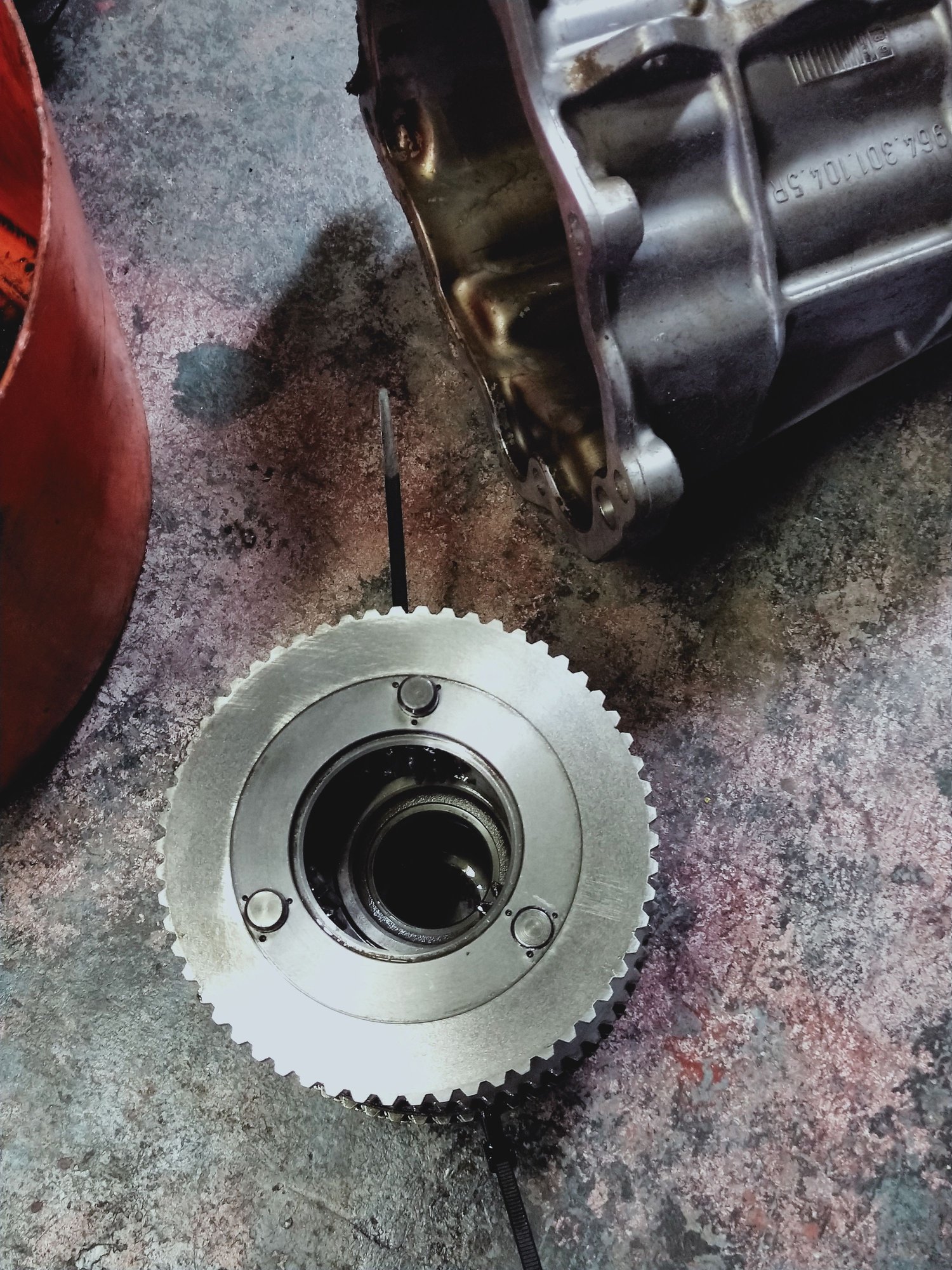

Looking around at what else to do to salvage the day I thought id start pulling the gearbox apart, started with the longtudenal diff lock housing and once this was off was pleasantly surprised to find all of the clutch discs in tact and seemingly in good shape.
The planetary gear which is often damaged on these due to the pins coming out looks great also but 2 of the pins were coming out and the 3rd is also loose.
Once cleaned I'll tig weld these in place on both sides stopping that from happening in the future.
Just checking, tig or braze?
Old Apr 30, 2023 | 02:44 AM
  #168
racoguy's Avatar
racoguy
Joined: Feb 2014
Posts: 392
Likes: 178
From: Auckland NZ
Tig is the only way.
