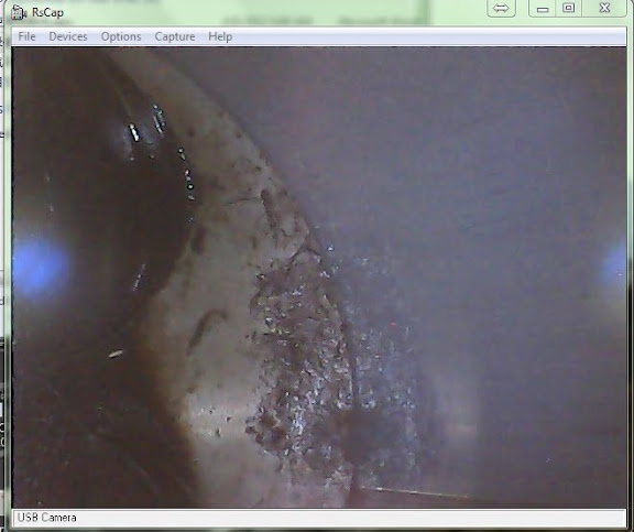

Cylinder number 7 is badly scored! The leakdown confirmed that the loss was through the rings (or maybe the cyl wall). And many of the pistons are in really bad condition. It is clear this car was knocking really really badly. Evidence below...
Cylinder #7
Another view...
One more...
Cyl #3(?)
Cyl #6
Cyl #4
So now the decision is what to do. In my opinion, this motor is toast - but drivable for a while. It might last a week or maybe a year.
I'm thinking I will get it tuned up a bit more and fix the oil-breather crap and then drive it. Meanwhile I will source a new motor. The only thing that might be useful on this motor are the heads.
Thoughts?
