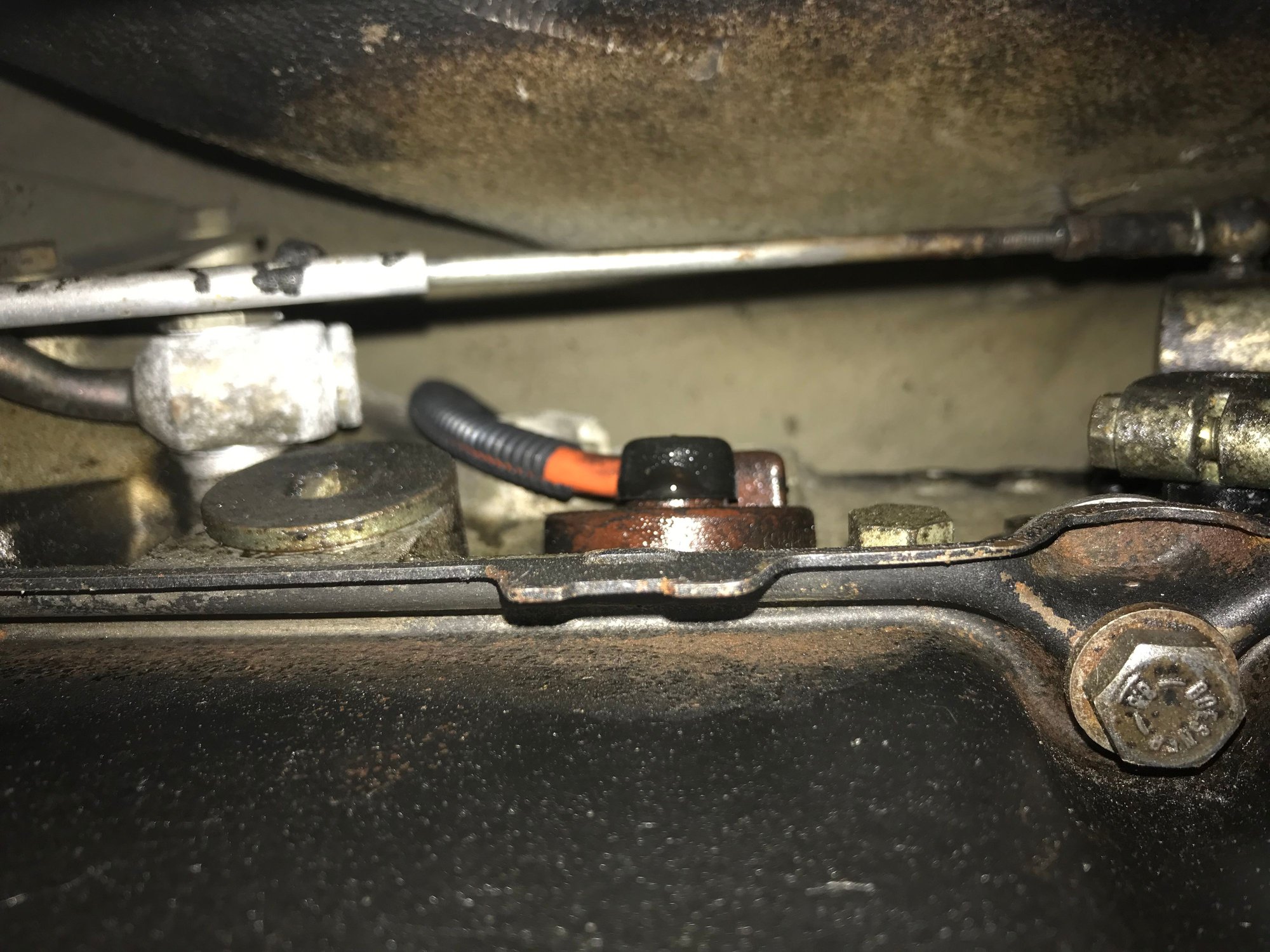

Ok, there are some noticeable differences, electronically speaking. I need some help understanding if blinding off the sensors on the newer ‘88 trans is ok, while installing it in place of the original ‘86.5.
there are two photos below showing two discrete sensors on the ‘88 (first 2 pics) that are not on the older ‘86.5 which is being replaced (last pic).
installing my ‘86.5 trans Cooler line will eliminate one sensor. The second lower sensor will be eliminated by the blind plug from my ‘86.5. Are there problems here? Beyond not getting improvements that the sensors may have provided on ‘88 cars this trans was actually installed on?
and to be clear… the car drives otherwise great. But it’s a driver. Much more than a good “original” ‘86.5 trans would be required to get it into purist category.

The lower is a pressure sensor for shift detection which is used by the S4-up ignition computer to retard briefly during shifts to protect the transmission.
The upper sensor is a temp switch for the S4-up fans. This may fit in the plugged port on the S3 cooler.
The fan switch on the S3 cooler was only fitted as part of the trailer package. It connected to the empty plug near the jump post.
