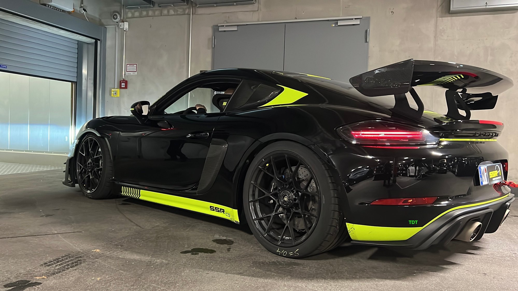

Randy Pobst hot lapped my car and then provided his opinion of the setup.
