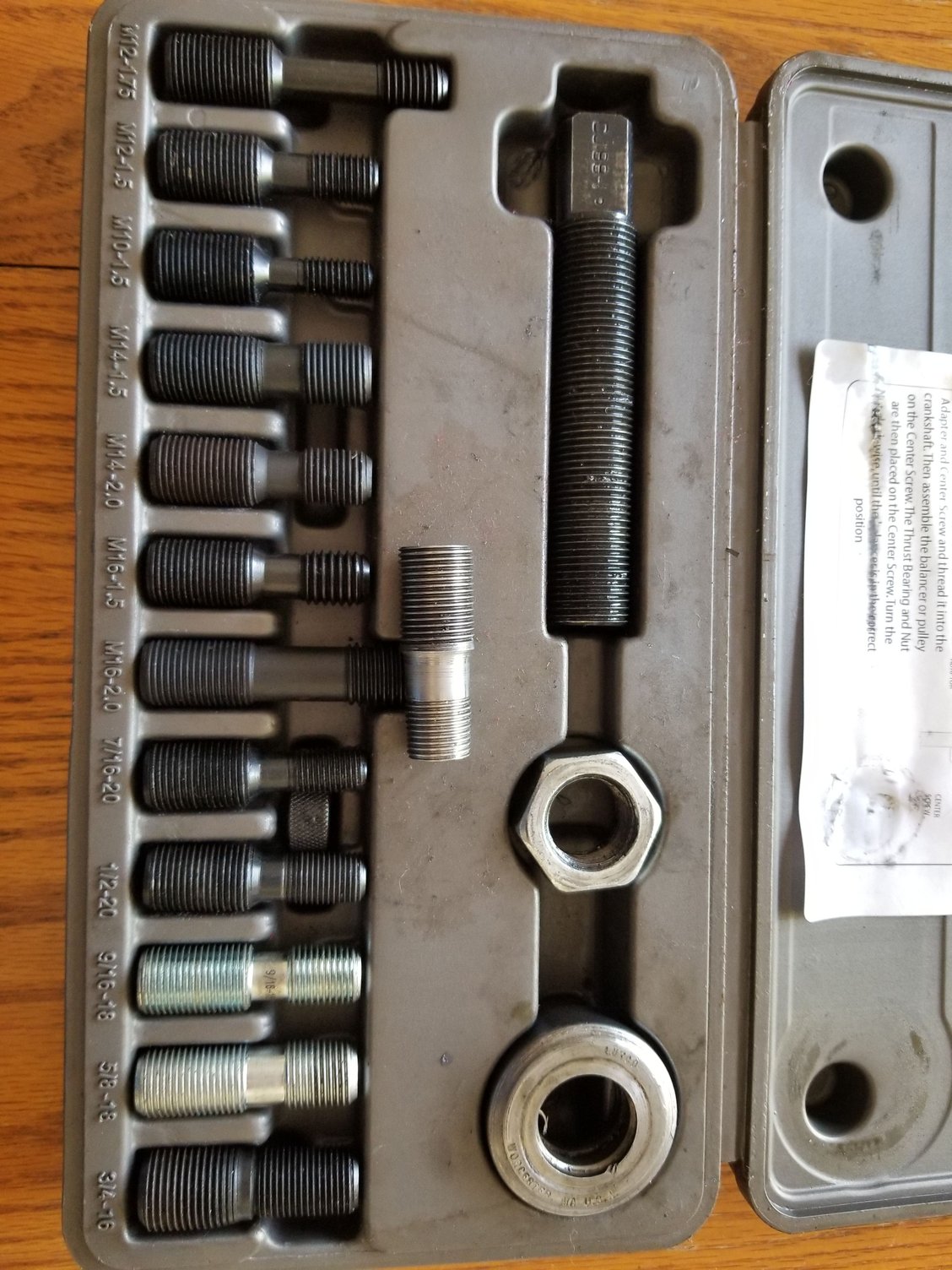

My machinist has a harmonic balancer installation kit and machined an adapter that matches the threads of our crankshaft. I'm hoping this will help me install the GB Super Damper.
M18 1.5 Thread adapter to press on a harmonic damper pictured in the center above.
You won't need it. Heat the hub as directed, oil the snout and it slides right on. You will need a hub puller to remove it though, no heat required.
