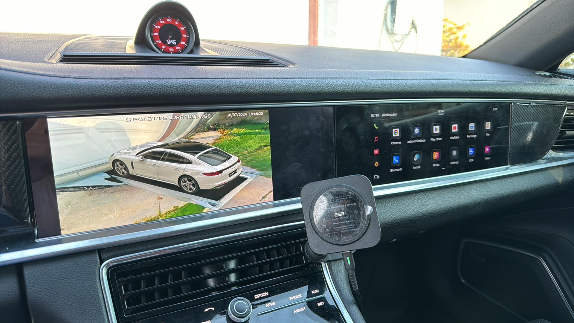

Jfyi, that photo is mine and that is my car. The real time traffic feature is lame, jsut use your phone to project it to the screen
