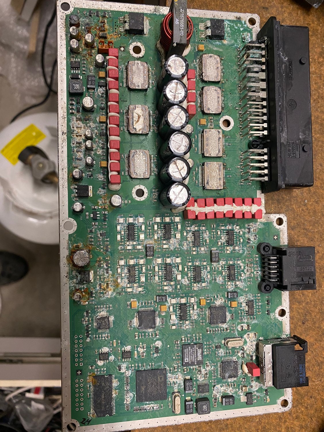

I tried the fan resistor from the ‘16 car and it didn’t work, the wiring location is slightly different on the newer unit and so it could not be bolted in place and plugged in but even with it just plugged in it didn’t work. This prompted me to put the blower motor to bench test and and I discovered it was stuck, not frozen but had a small piece of debris somewhere and once I moved the rotor everything freed up and it now works fine, none of it was corroded so hopefully it all good but otherwise I’ll buy a new blower.
I switched out the rear climate controls for the ones from the other car and they work! The only issue is the other car has different options so I’ve ordered a replacement part from eBay.
all good so far but now the bad bit!
I pulled out the amplifier and opened it up, it’s so damaged inside that it’s never going to work again.
i even sent pictures to a company that repairs them and they said they didn’t want to touch it haha, so I’ve purchased a replacement from eBay!
almost there guys!!
I’ll upload the picture of the inside of the amp so any of you guys who are curious can see what they look like inside, although I hope yours don’t look like this lol!!
