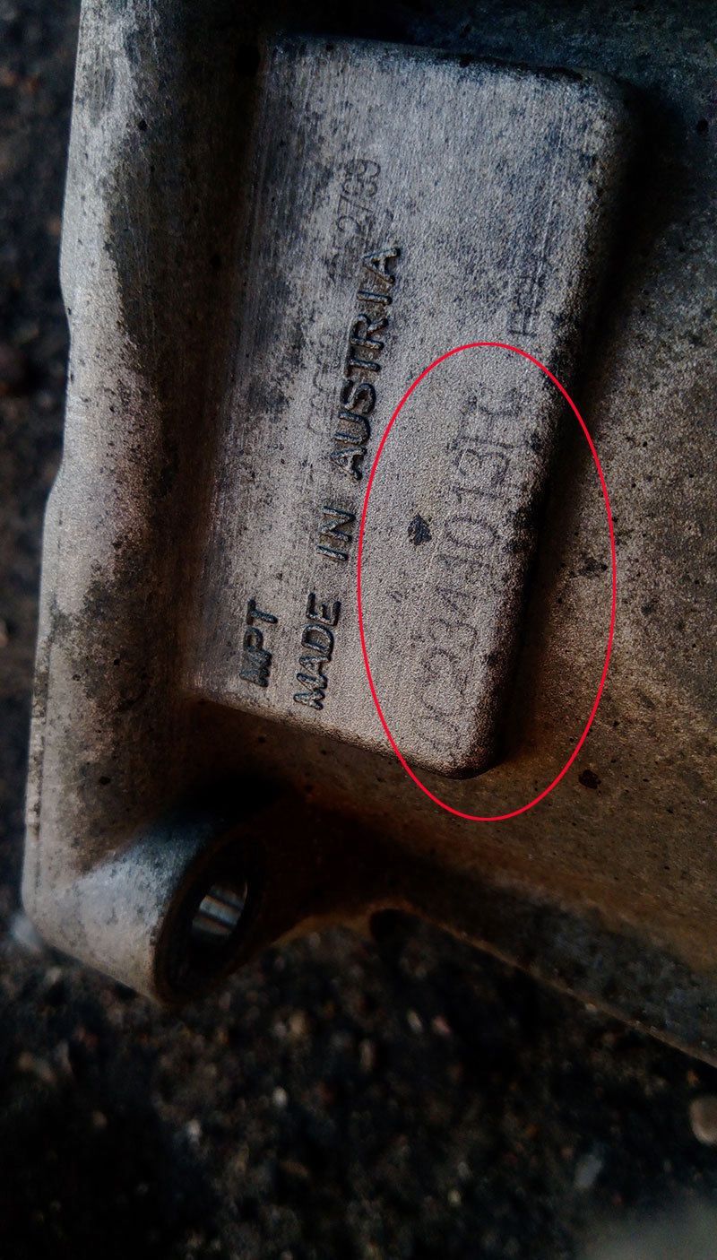

I've had my case apart and took pictures at that time. When I look at the pictures I don't see any part numbers that correspond to your post. The closest I can come is a series of numbers 485 1122337MPTL. The case is a 95834101008 FYI. Where would you find the numbers you mention.
I may open mine up again if the stepper motor does not fix my problems. I should know by Friday COB. Thx
I may open mine up again if the stepper motor does not fix my problems. I should know by Friday COB. Thx[/QUOTE]
From awdtech site: This kit fits only if your number starting with 95834101
So their parts set is correct - https://awd.tech/collections/pl72-at...tc-bmw-porsche
What is the problem you experience?

The two likely cases are the PL72ATC which is the active transfer case and the most common option and the other is a PL72T with a Torsen differential. The company name is AWD Tech.
Has anyone tried to rebuilding one of these?
If you have the actuator, perhaps that is what you are calling the stepper motor, then it is likely the ATC. As for the numbers I quoted you won't find those on the unit. The numbers I provided are the actual model of the transfer case from the manufacturer - not the Porsche numbers. There is a badge on the bottom of the unit with some numbers on it - etched below some raised text that says MADE IN AUSTRIA. If the numbers are still legible you can send those to AWD and they will let you know. The easiest way I corresponded with him was via Ebay but I can ask for a direct link. They do have a website as well but the Ebay messaging worked well. See pics below and the Ebay link for the clutch friction discs. He also has the chains.
https://www.ebay.com/itm/263086908030?ul_noapp=true

1) 958th may be equipped with different transfer cases. The most significant differences you should find out - does it has actuator? If yes, this is PL72ATC - Active Transfer Case (the most common option). Otherwise - you have a PL72T transfer case with Torsen differential.
2) PL72ATC has 2 significant modification - 1" or 1.25" chain (width).
3) Useful diagrams: https://awd.tech/pages/pl72atc-diagram, https://awd.tech/pages/pl72t-diagram
4) Most common issues with PL72ATC are wear of clutch and stretching of chain. The PL72T's common fault is stretching of chain.
The symptoms you have described seems like worn-out clutch but I suggest to replace it together with chain if your t/c equipped with 1" one.
