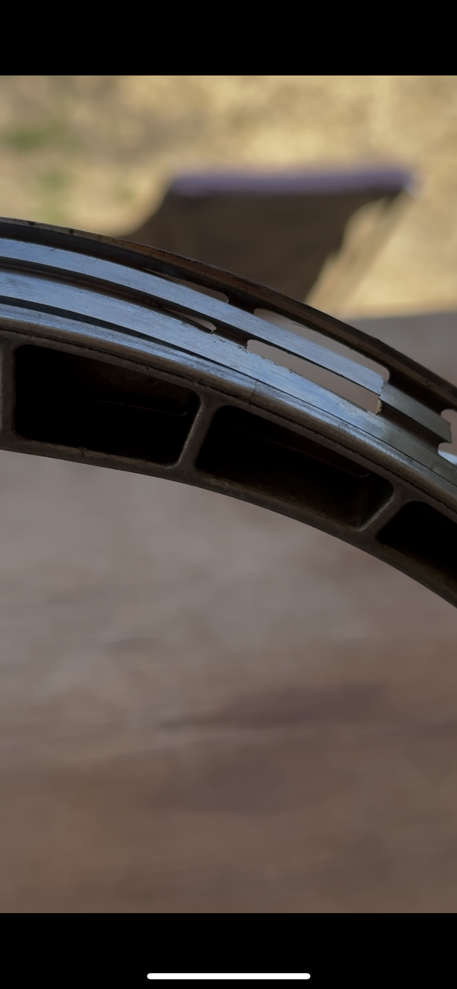

Starting this post about halfway through the timing chain replacement on the 2013 S and have successfully stripped 3 timing cover screw heads, found 2 broken valve cover screws (someone’s been in there before), and have had several moments thinking ‘That’s why they say ‘engine out’ for this job’.
Through all of those moments, my neighbor (shoutout to Greg who has helped me with several of these types of projects) and I have the new timing chain on and in place to re-install the timing cover and begin the timing process. Before embarking on this project, keep in mind that you will need the cam-timing tool set and the Porsche Vibration Damper Counter Holder, which I now have both and if you're local or close to Tulsa, OK, I'd be happy to loan them out. It would be a good idea to order the timing cover hardware which is approximately 30 screws of varying sizes (all available in the shop manual), outside of the direct replacement parts that you’d expect to order. Doing this job is fairly involved but can be done without pulling the engine. I would be happy to share any pictures or notes of specific things anyone has questions about various points of the process.
More updates after we get the timing cover, timing set, and the rest of the project buttoned up-
