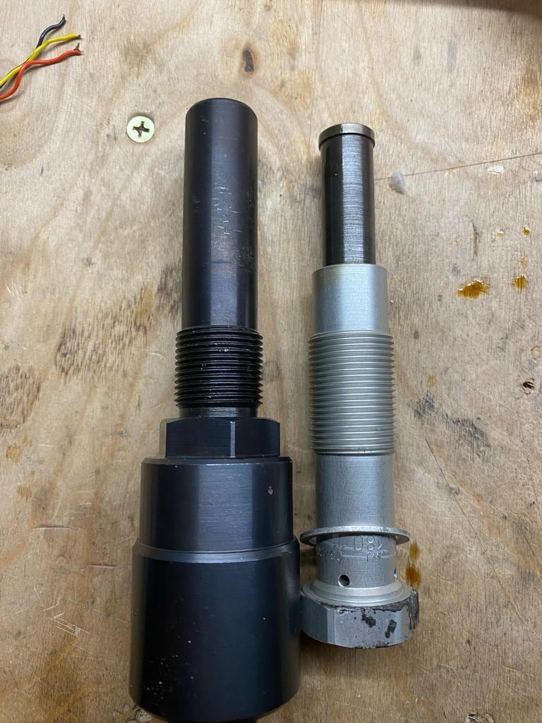

Heres my original tensioner next to the ebay pneumatic tensioner. Looks to be the same thread pitch.
So i went full ghetto on this and installed a Schrader valve and used my hand held electric pump to get it up to pressure. Worked just fine given that its such a small volume of air its displacing!
P.S if you are in the states i am happy to send you my full kit for the cost of shipping (as long as you return it once you are done). im pretty sure i can get it to fit in a large flat rate USPS box.
EDIT; OR if you just want me to send you the tensioner, PM me your address!
Wow, you are so kind - thank you! I would take you up on the offer, but I have numerous V8s to do this on, so I am going to just return the eBay kit I got (with the wrong pitch), and spend a bit more to get the kit with both versions of the tensioner tool. Thanks again, though!

Originally Posted by garrett376
And what hose fitting did you fit to their oddly shaped silver fitting? I replaced it with a standard industrial fitting, but I'm curious what hooks up to that silver fitting.
Garrett,
It's been a while since I did mine, but I think I had to replace the fitting with a more standard quick release type fitting which you've done. Also, late on the conversation and I see you've already figured out the mismatched threads, but I sourced my camshaft kit from a seller on Amazon and was around $100 at the time. I see another post from DemonBG with a very cool idea of using a Shrader tire valve to hold the pressure there. Like it!
