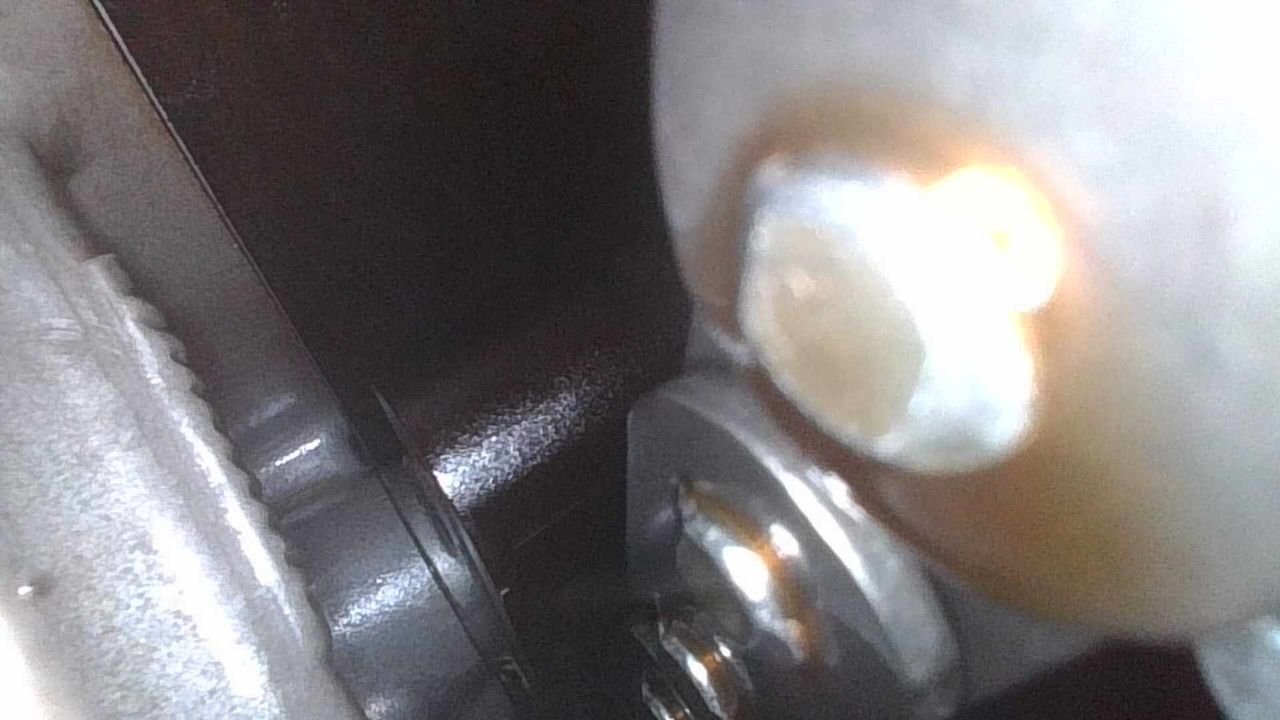

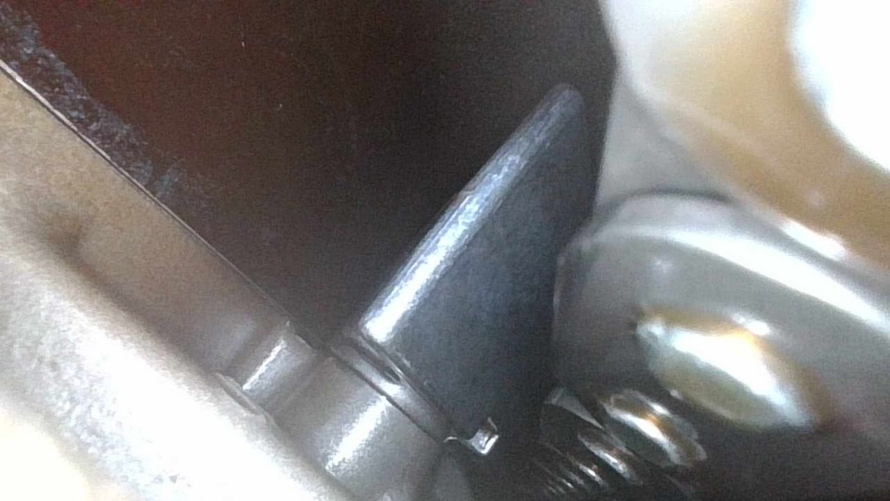

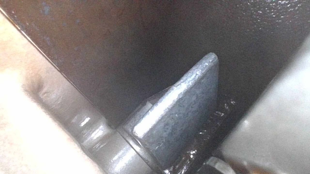

Some examples for you:
Look like this and you're good (130k miles):
Just starting @103k miles:
Looking bad @117k miles:
@garrett376 thanks for sending those examples! i apologize for my ignorance but what exactly are we looking for in those pictures? in the first picture i dont see that silver triangle piece at all, thats to the left of the chain, why is that? is seeing that what determines if your in bad shape or not? Is that one of the guides? Thanks again.
Even a good pic, doesn't show brittle material. It could fail miles later... Honestly, this is why I am hesitant in getting another.

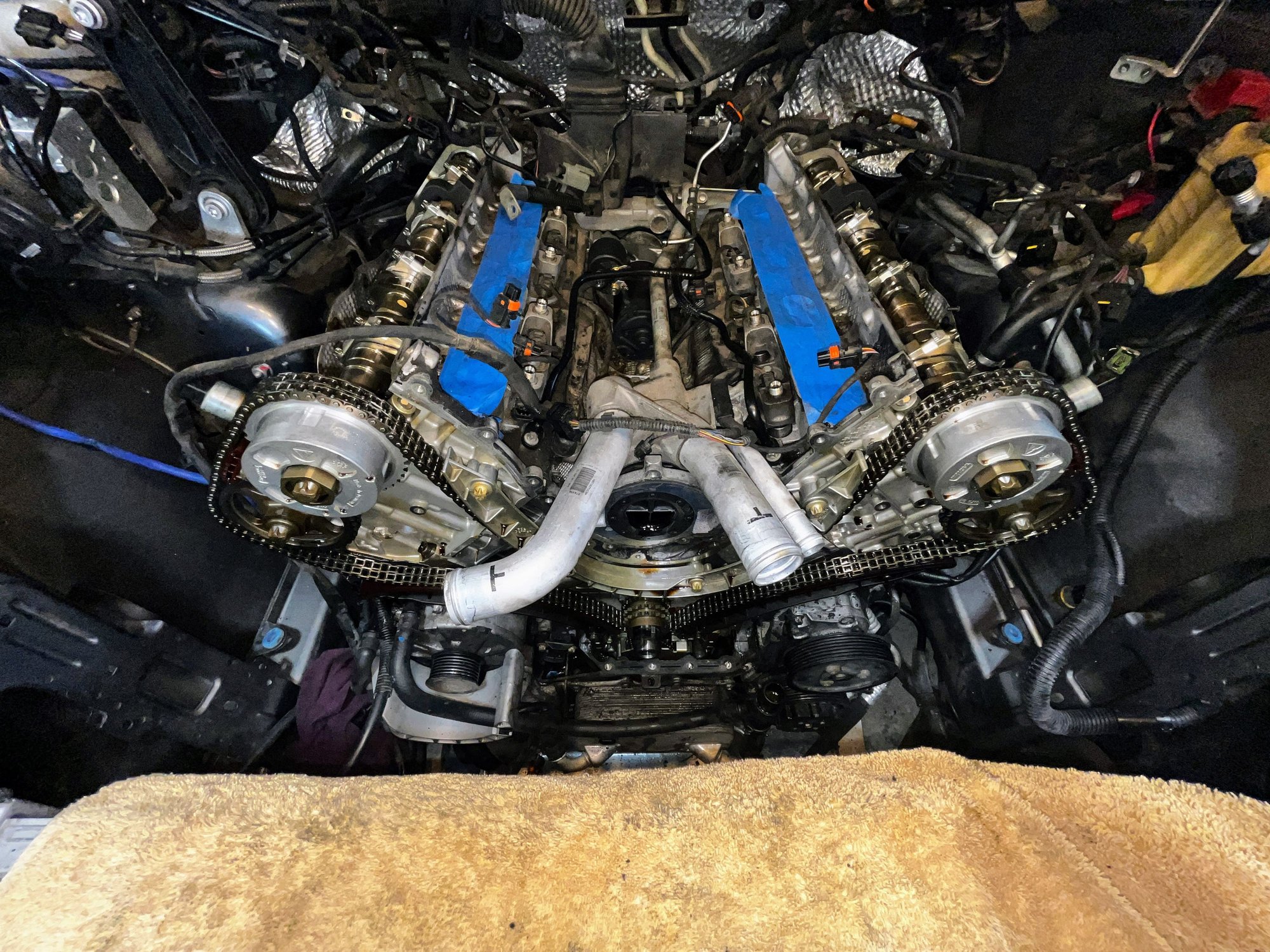

My 2012 958 is waiting for an open spot in the shop. Having all the parts, I can say that my wife is very patient.
Garrett is the man. I wanted to add a few comments.
I would recommend fasteners and valve cover gaskets, as well as the camshaft holding tool.
Fasteners are single use, torque to yield. I am not good enough to hit 6 Inch/Pounds +90. Removed ones have been stretched past their elastic stage, and have a better chance of snapping. Look at VW shops for these. Last check they were around $1 ea. Look for valve cover and timing cover. And just a bit of advice from a Boomer, maybe buy 1 or 2 extra. Drop or lose 1 and you will be a believer.
Figure out how you want to remove the harmonic balancer! You will need this for removal and install. Seems like the torque spec is pretty steep. I didn't want to remove the front, damage the radiator or buy a new balancer. I got the "holder" and it seem like it is 4' long. I'll sure I will do this in another 100k, so might as well hang on to it for then. But again, choose a proven method you are comfortable with.
Do I remember a chain tensioner in the kit? Again, this depends on your risk aversion. Probably not necessary, but ... it's an integral part. For me, it's insurance.
Tools for torquing (that's not the same as the nasty dancing I hope). Seems like you will need something with a range less than 10 in/lb. Again, doing this from memory, but many tools have 20 for their lower limit. A fairly inexpensive tool is the Fix-It-Sticks. You can use on a 1/4 ratchet and get into all kinds of places. You will have to hit the +90 degree on your own, though. You can trust the accuracy of Fixit-Sticks out of the box, unlike cheap in/lb torque wrenches.
RTV. I'm going with the spec'd material this time Locktite SI 5900 is around $24 on AMZ. You could probably pick up a tube for $7, aerosol for $17. For me, this was worth the extra $20 knowing this would not be the failure. Book shows about 40 hrs (?) labor for skilled labor. I would hate to rework or settle for a leak.
I'm old. I like to pinch pennies. But I've also seen too many times where I wish I would have taken that extra step. I'm not trying to scare you, just speaking from my experience. Snap a head on the last timing cover fastener, and that $30 for new ones will seem like a bargain. A leak at the valve cover has driven me nuts because the RTV I chose was not the correct viscosity and did not fill the gap effectively. +$20, count me in. And I feel like a really old man saying this, because I remember thinking the man who told me this was old when he said it to me. Be careful stepping over dollars to pick up pennies. This is a big, doable project. There is a reason shops charge $ thousands. An extra $100 tactically spent may be an investment in time and money.
