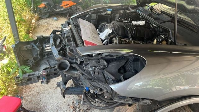

Hi, just finished the timing chain. Did it myself. Bigest issue was the crankshaft bold. Had to remove the bumper and unscrew half of the front to get enough space for an impact.

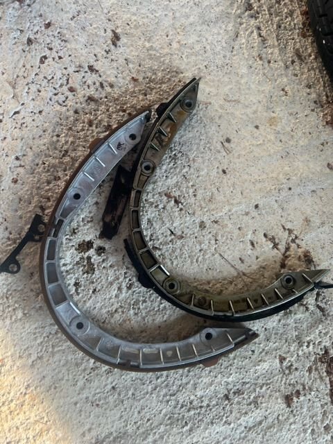

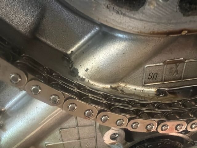

ive looked both chains and thei are the same size- so no chain stratch but the U glide was completly broken. Also the part on the chaintensioner got a big crack.

had the famouse p0016 code. After half a year it went from intermitten to all the time with psm-cel.
then i checked with a little camera and saw that the glide was missing the plastic. (Picture is more up in the thread).
edit: oh the millage is now 244 400 km but the light came first on at around 230 000 km

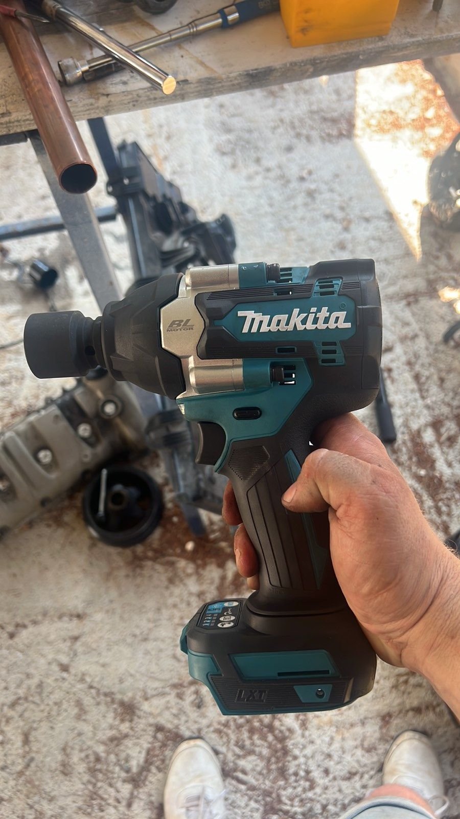

i used at the end this one.

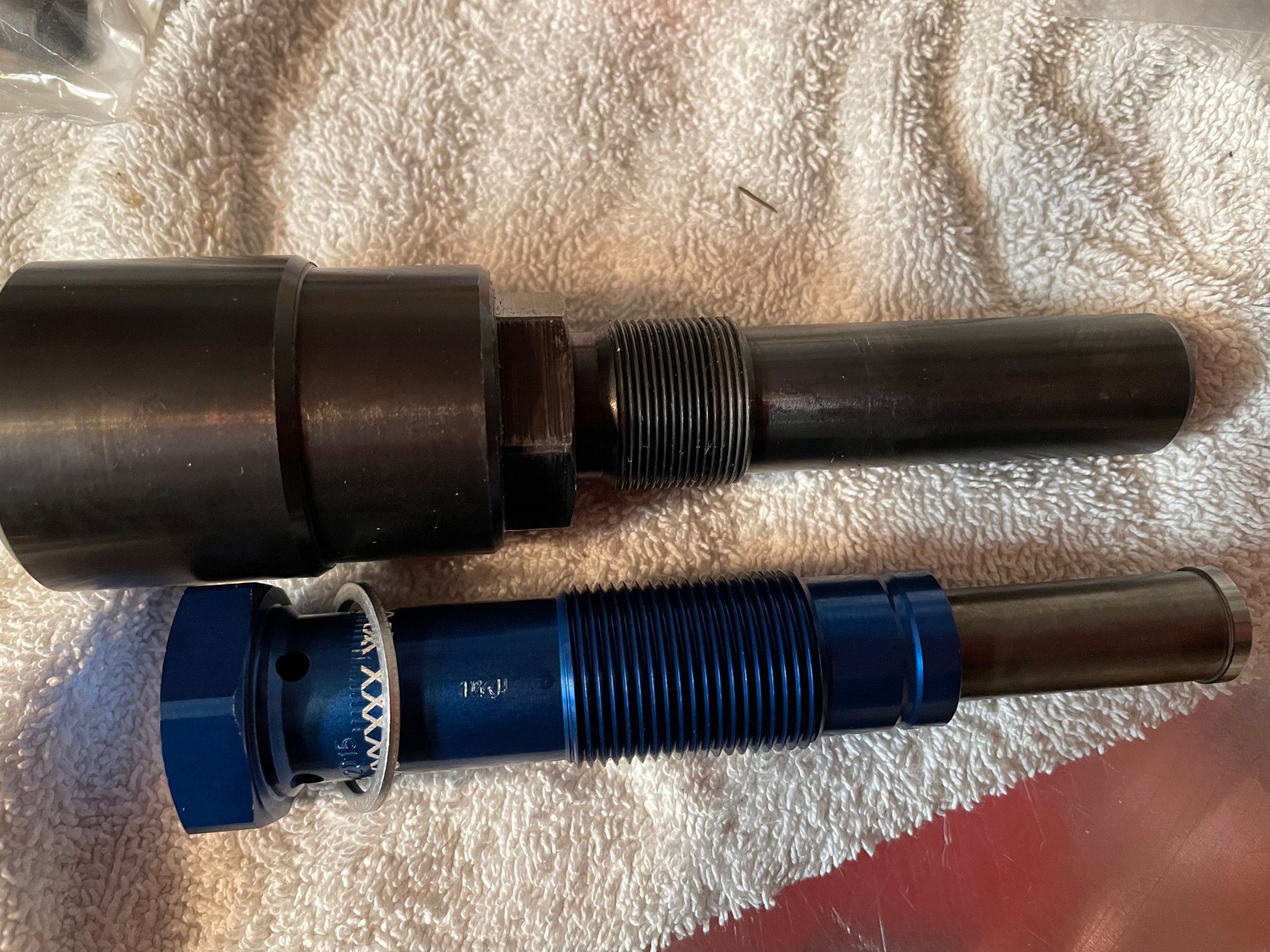

Alright, Team! Got a question for all of you timing chain mechanics in the house:

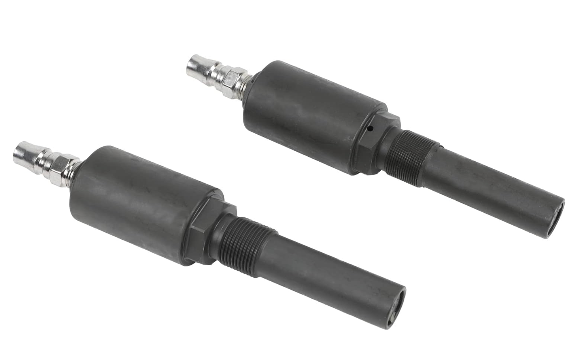

Every kit I see on eBay has a pneumatic tensioner that has the incorrect thread pitch. Fortunately I noticed this before I went nuts screwing it in...
Where did you all source the proper pneumatic tensioner tool? Thank you!

Ok, I posted too soon; I see there are two types available. Unfortunately I've got the wrong type.

The bigger 1.5 pitch is what's needed... I found this:
amazon kit amazon kit
That has both sizes, including the correct bigger pitch one. Strange all the eBay sellers have the wrong version.. at least for a 958.
