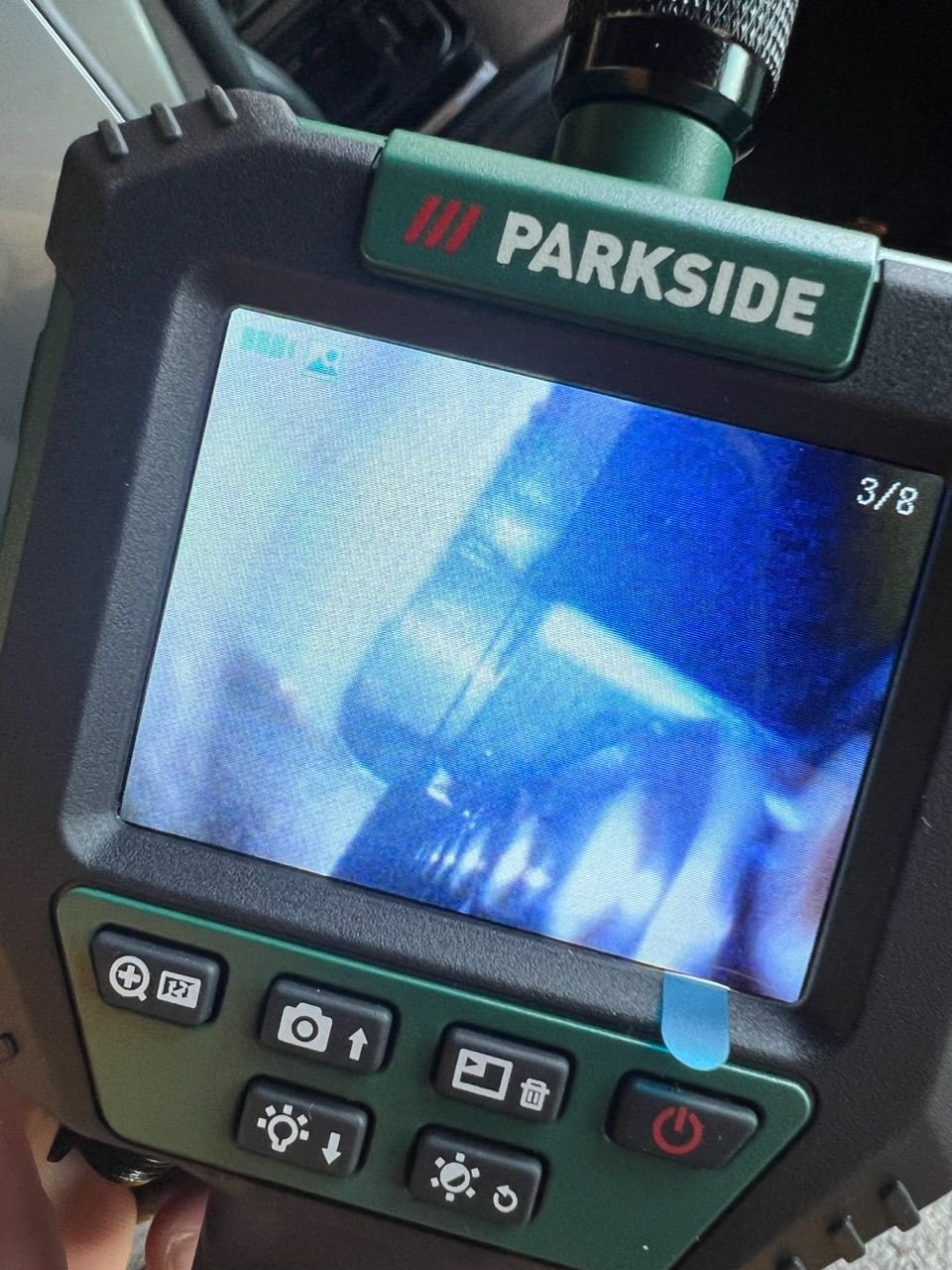

Hi,
today I remembered that i have a small camera and looked trough the oilcap if I can see the chain guide and there was no plastic.
my simptomes are here and there the p0016 code and psm light on the dash and a message that the start/stop does not work. However this error is intermitted, only in the morning and not always. My indy told me he do not want to do the job if i think to cheap out.
now my question is what should I do change beside of the chain and the tensioners and guides. Oil pump? Water pump? Pulleys?

Originally Posted by zmaj
Hi,
It may be intermittent now, but the CEL will eventually be constant. My CS ran fine with no chain slap and others have reported similar. Even still, it's something you must repair and soon. I would plan to use new bolts for the camshaft sprockets and crank harmonic balancer. When you remove the timing cover, expect to find 3 or 4 snapped aluminum screws so plan to use all new screws there. Don't over torque those screws! I've seen posts where some owners now use steel screws for replacements. Replace the water pump, valve cover and intake manifold gaskets. New serpentine belt and for those idler pulleys, optional. Mine were OK and you can always easily do those later at any time if they start to squeal. New timing cover gasket set and crankshaft seal. Using my procedure, it's not possible to replace the oil pump or its drive chain.
Good luck..
