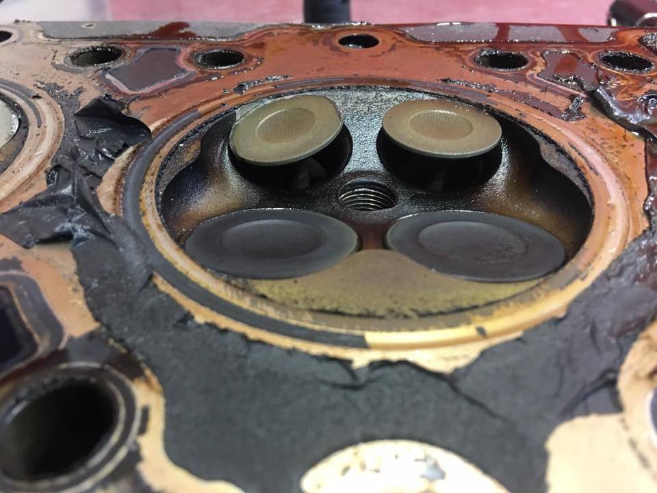

Dealing with a failure like this is nothing around here... It cost some money, but put it back together with my IMS Solution, and you'll not be making a post like this one in the future.
I found a broken M96 powered Porsche for my Mother- in law a couple of months ago. It was also a classic low mileage car that had an IMS Bearing failure. I pulled the engine apart last Wednesday, and I am re- installing the cylinder heads today after the full repair has been done. Here's some pics of her failure. This isn't the end of the world, unless you let it be......
![](https://cimg7.ibsrv.net/gimg/rennlist.com-vbulletin/2000x1504/img_3158_3b2ce170917e68f6f38e8238e0149bc7a080dd92.jpg)
![](https://cimg1.ibsrv.net/gimg/rennlist.com-vbulletin/2000x1504/img_3159_584e808c2c09206bf7f722fb3f0a4b000b2de37e.jpg)
![](https://cimg3.ibsrv.net/gimg/rennlist.com-vbulletin/2000x1504/img_3160_64b362b1fc1167b1595ddc446c63534a917eb941.jpg)
![](https://cimg7.ibsrv.net/gimg/rennlist.com-vbulletin/2000x1504/img_3162_dcca673088ccd08b173d4f789cdd9d4bd8fcbe5c.jpg)
![](https://cimg8.ibsrv.net/gimg/rennlist.com-vbulletin/960x720/14572399_10210816965397767_409087785905362190_n_c22c1663736913a0c5323cb8242441e74e490994.jpg)
![](https://cimg9.ibsrv.net/gimg/rennlist.com-vbulletin/960x720/14666326_10210816963917730_3039635911129144706_n_e91df596ae617c9c34808bd70aedc9b2c0c48bfa.jpg)
![](https://cimg1.ibsrv.net/gimg/rennlist.com-vbulletin/960x720/14717322_10210816963717725_4640774768619197848_n_d8e915ccfd5ffd84d6c273291b9bc0e1718ae4e7.jpg)
![](https://cimg0.ibsrv.net/gimg/rennlist.com-vbulletin/960x720/14713557_10210816964677749_1667928372298270955_n_2920a100bff22c362d1b6edeaaa2599fe4d7876d.jpg)
![](https://cimg5.ibsrv.net/gimg/rennlist.com-vbulletin/720x960/14717293_10210838780983143_7223841132284317712_n_92b44d1662d365bb6fe30d1a56b88754a3dd09c3.jpg)
Reassembly started on Friday, all components cleaned of debris via ultrasonics, and all collateral damage taken care of. Fitted with an IMS Solution.
![](https://cimg4.ibsrv.net/gimg/rennlist.com-vbulletin/720x960/14702285_10210864726231758_4576622267581982233_n_d6efbcd6cdaa1262ea148a7ab94885c4751bf6f0.jpg)
Where it stands this morning... Waiting on my cylinder head tech to finish the heads, they should be on before midnight, tonight.... Should be running Wednesday...
