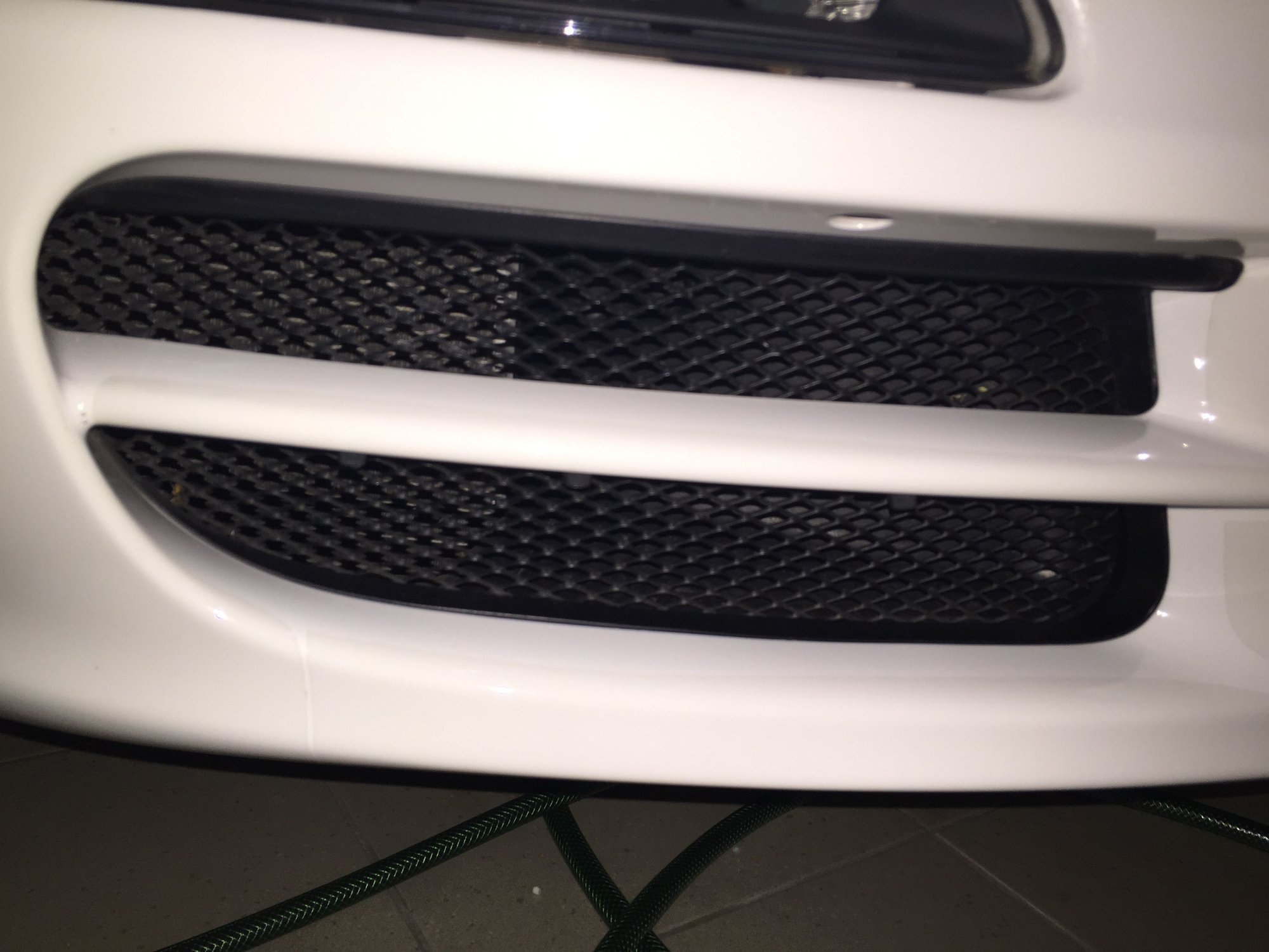

You can hide the zip ties on a 997.1. This is mine. I pull the zip ties inside the horizontal bar. Cannot see it if you stand in front of car. You can do it without removing bumper.

^^^^ that's what I'm talking about. if you use zip ties, hide it so it won't be seen. otherwise it'll look cheap. nicely done & clean look

There are several grille/mesh threads here. In one of them I posted measurements of the mesh and a short "how to". Cannot find the thread now though...
Basically you start with cardboard and test until you have right shape. Then you cut the mesh. When done you can actually slide it in between the bars in the grille and fold it up in place. Helps to put in a few cable ties in the mesh to use for guidance.
