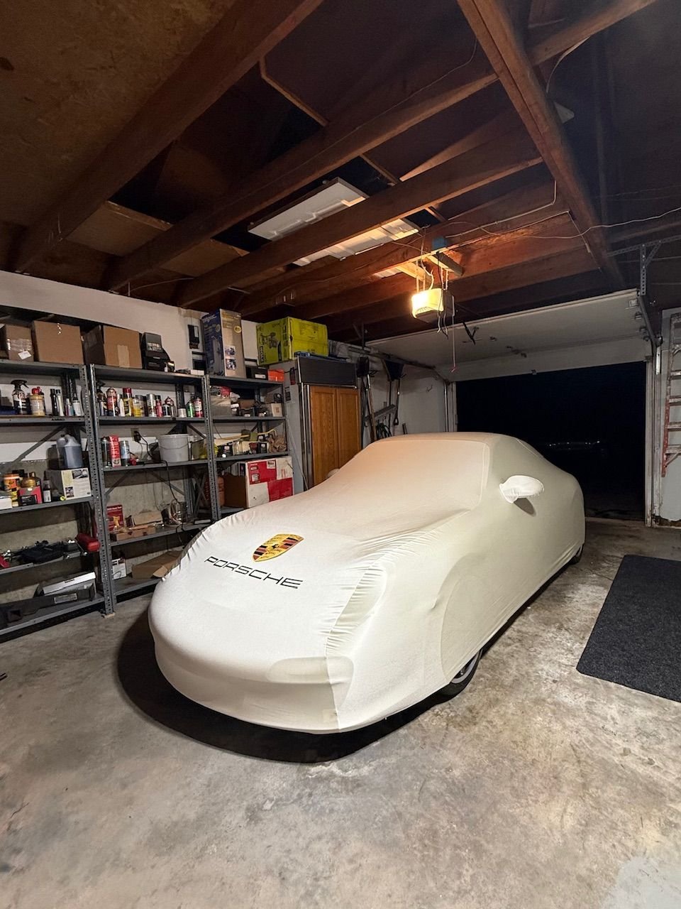

Just went through this process yesterday - I leave mine on a tender. Last year I went no cover, but this year I found a good deal here on an indoor cover so decided to give that a try. Washed and detailed on the outside. As for the inside, I conditioned the leather and placed a moister absorber on the back seat. Also cracked the passenger window slightly to further prevent any moister inside.
