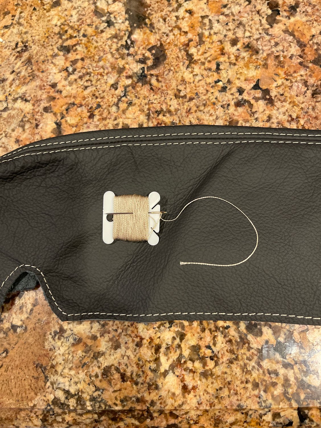

Side view mirror housing protection
Leather sun visors
Stitching for visor

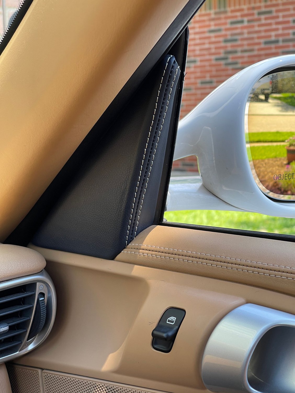

Leather mirror triangles
Inside triangle trim

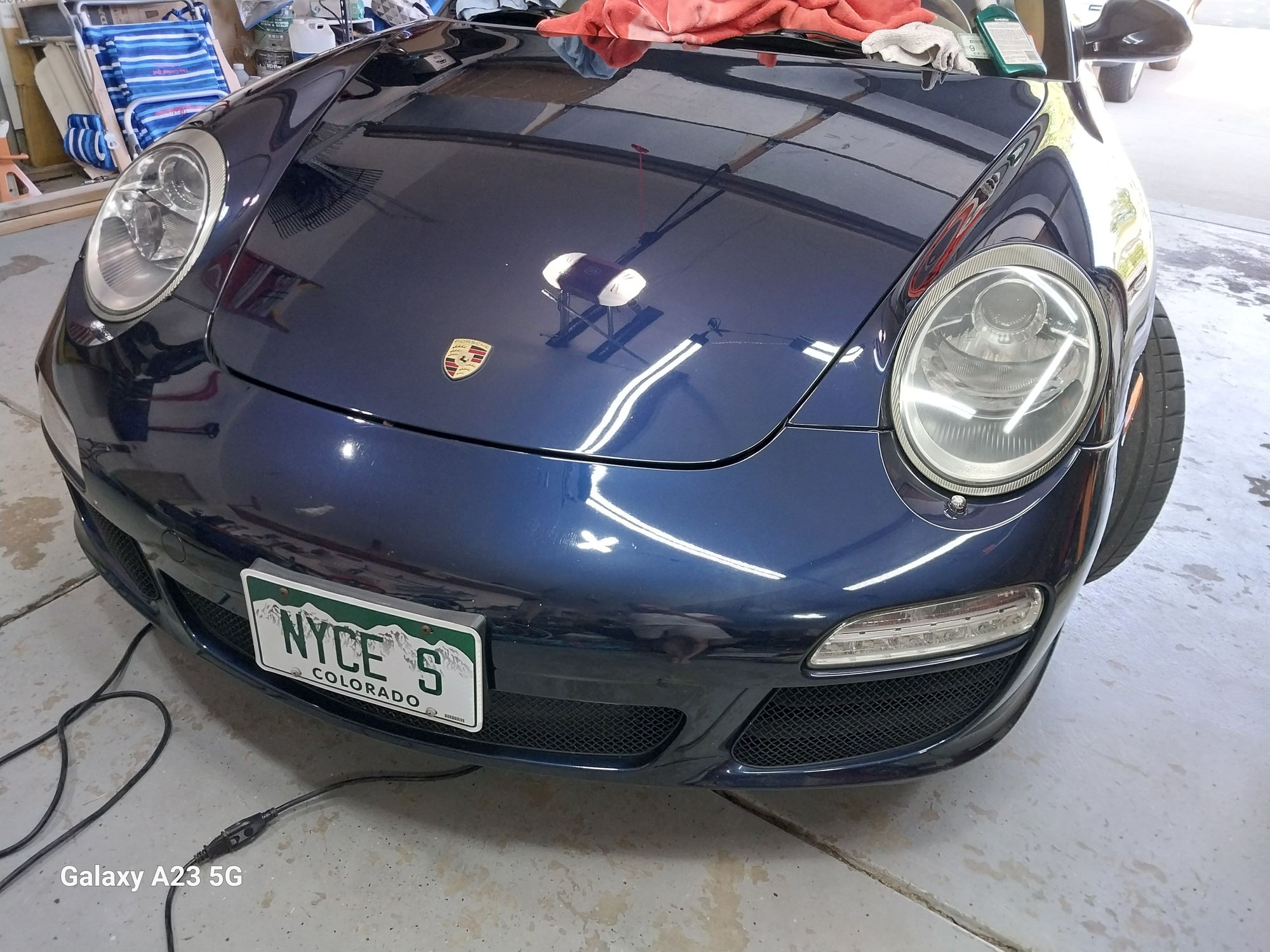

One of the headlights on my 09 was replaced. I forgot to ask my brother why. The difference was something a non car person noticed when I showed him the 968 in my garage. Yesterday I compounded and polished the nose of the car. It lived by the Atlantic since 2016 when my brother bought it, and he didnt garage it. I went over the hazy headlight as if it was part of the hood. I think it came out pretty good. I used the Mother's blue ball with a drill on my S80 some years ago. They were in bad shape with lots of pits in the plastic. That worked great too. I recommend removing the assembly if you use the Mother's system. My opinion which is worth nothing is any polish will do. In HS I polished the edges of scrap pieces of plexiglass that was made into keychains. It isnt the product as much as the time spent and pressure (or lack of) applied.
