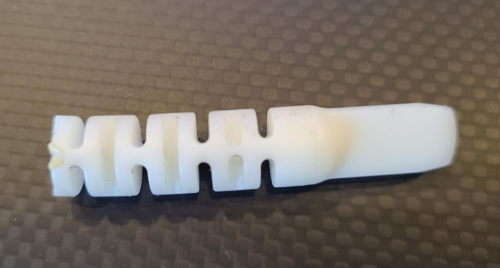

I removed the door panel to find that this chord that attaches at the back of the lock cylinder was snapped off and sitting inside the bottom of the door.
Door Lock Cylinder Chord

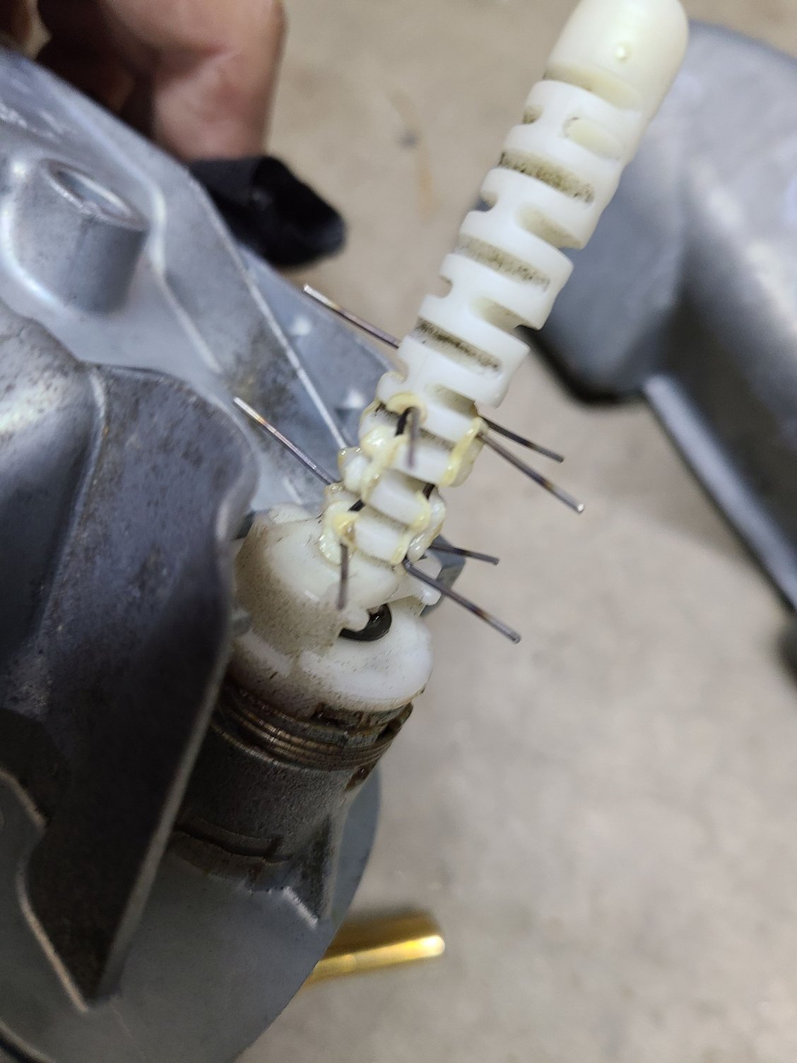

Not wanting to shell out $1,235 for what effectively amounts to a broken piece of plastic, I attempted to hot-staple / plastic-weld the broken chord back together:
Hot-stapled chord welded back on to lock cylinder.
The "repaired" chord seemed pretty strong/sturdy and after I re-assembled the door, and it worked for exactly one lock cycle.
The door locked with the key turn... but then when I went to unlock with the key, it went back to turning 180° with no resistance.
I didn't feel anything break, or hear any noises, it just simply wouldn't unlock.
Luckily the key fob button still worked to unlock/lock the door.
I have not re-opened the door innards to see if the chord broke again or if the chord simply slid out of it's slot in the door lock assembly.
Just curious if anyone has experienced anything similar... or if you have any thoughts other than paying $1,235 to fix this?

I finally opened the door panel back up and found that the cord broke again, but interestingly this time it sheared off above the repair I did.
This tells me two things:
1) The repair that I did with the hot staples worked. In fact, it seems that the stapled section was stronger than the remaining intact chord where the new break occurred.
2) The problem is likely in the lock actuator providing too must resistance to turning the key (and the connected lock cylinder cord)
So I've ordered a new lock actuator AND rather than attempting another repair on the cord (I'm not sure it could take another round of hot staples), I'm ready to bite the bullet and buy the new door lock cylinder part. I've attempted to order a new lock support with a new embedded cord; the lock support contains the coded-lock cylinder which needs to be built in Germany to match my car's VIN. I say "attempted" because I've tried to place orders at three separate Porsche OEM online suppliers (one in Florida, one in Maryland, and one in Ohio) and they've all initially accepted my order only to subsequently cancel the transaction saying that the part would need to be picked up locally, and I would need to present proof of registration/ownership when I pick it up. Apparently this is a Porsche policy and there is no getting around it. This seems ridiculous to me, as the part is several layers deep inside the door and it still requires a functioning key to unlock the car... I can't see how it would benefit a car thief to request this part be built in Germany....maybe I'm missing something?

The Nylon/Delrin (polyamide, or acetal) part is designed to be a "weak link" AKA a mechanical fuse in the locking system. They are made to fail first before damage is done to the lock/latch when someone thinks they are breaking into a car by overpowering the key rotation by "Strong Arm " dumbass technique. However the part you are messing with is purely mechanical and the only critical security part is the lock cylinder itself that is keyed to your car. Take apart the assembly and remove the cylinder and swap it over to a new/used one. However you need to find out where the resistance is coming from so you don't break another one. I am familiar with the door latch itself (VW part) but not sure how the outside handle fits into the scheme of things.
1) Gluing acetal or polyamide parts is not going to work.
2) Let us know your success in removing the lock cylinder from the mechanism.
3) carve a new "fuse link" out of hickory
Usually the only time the key lock is used is when the battery goes dead and you need to get into the car to do the "open the frunk" dance.

Interestingly this nylon part is metal in both the 996, and they went back to a metal shaft with only a plastic tip in the 991. It seems Porsche only used 100% nylon for this part in the 9X7 generation.

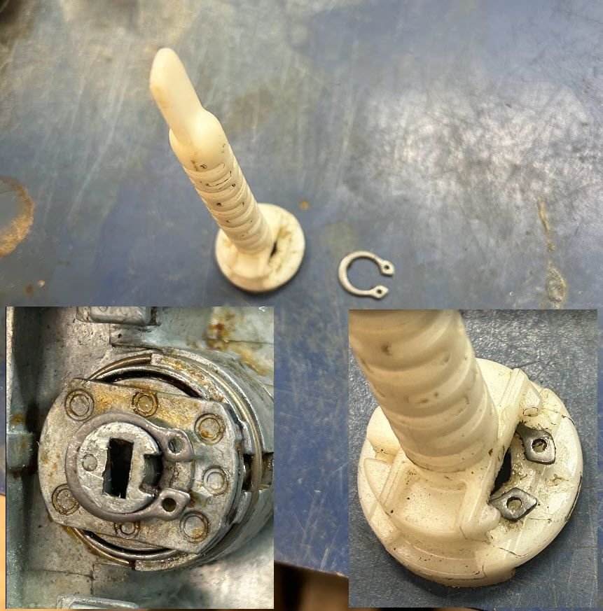

Updating this thread in case somebody else is searching for this information...
My experience was different! The white nylon part is held in place with an external snap ring and is easily removed. My original part and used ebay part are identical.
I can't figure out how others concluded that this part cannot be removed. Maybe the snap ring can rotate such that the tabs are not readily visible?
