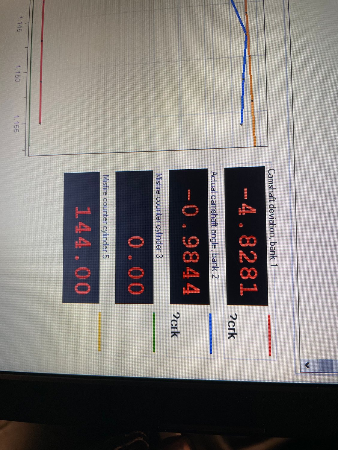

Could someone provide feedback on these numbers? I now have a cylinder 5 misfire with rough idle and running. Car has a noticable shake when idling

Can you show bank 2 numbers as well?

Both banks are there - Bank 1 top box & Bank 2 bottom box

How many miles on your car?
I seem to remember Camshaft Deviation #'s problematic when #'s reach 5.0 or so?
Bank 1 at 4.8 looks like it is close to 5.0 and Bank 2 at 3.9 almost 4 not that far behind.
The Camshaft #'s on the 2 997's I had PPI's done recently were in the 2.0/ & 1.8 range which was not an area of concern according to feedback. Both cars had higher mileage at 87K and 95K

I am not sure if 4.8 degrees would cause the engine to idle badly. But if something is wrong with your cyl 5, that would cause a bad idle. Pull the plug on that 5 and read it.

Those deviations are in spec, it’s most likely the plug, coil pack, or injector.
I would start by looking at the plug.
you could also get out a stethoscope and put it on injector 4 while running. They make a very distinctive click when working properly. Then move to 5 and compare.
