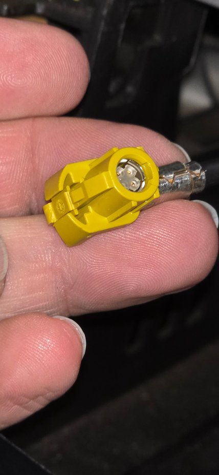

I finally had a chance to work on installing the new Owtosin unit and am down to the last connections. Big thanks to @MattDevoCustoms for graciously answering my questions and correcting a few things I had mixed up.
I have the black and yellow from the MOST box spliced in, just need to do the red.
Where does this connector go?

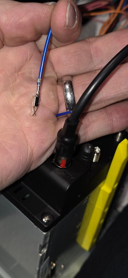

This blue wire from the antenna needs to tie in to a switched power line, correct? Is the red ACC from the main harness the correct link?
