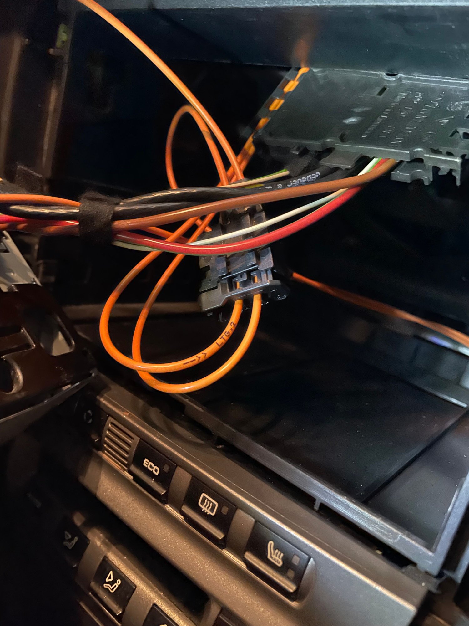

I removed my radio to see the connections. They ask I take a photo.
^ what am I look at here? Radio has Bose.

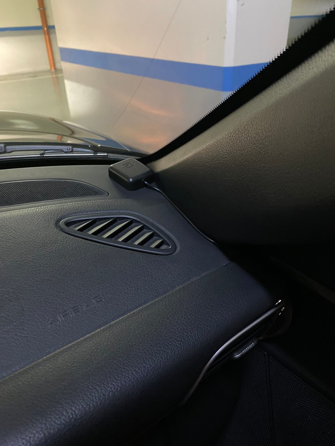

just installed the 7862 Heregoes 8GB 125GB from Ali Express and I hv to say I'm impressed , a great value for the money ! I have 2 small issues the installer connected the gps part that comes with the box and placed it on the dashboard (passenger side) which looks out of place!! do I need this part ? I have the CarPlay connected wirelessly so would I need this gps part to be connected and visible ? another thing is that I have 2 cables coming out of the sceen with 2 USB A and I don't like how they look!! is there a way to hide then or place them in a better place? third thing is that the buttons lighting is Red which don't suit the rest of the OEM buttons in AC (White light) is there a way in the settings to change the color of the Headunit ? pix attached

You don't need the GPS dongle if you're using Carplay as it gets the GPS signal from your phone.

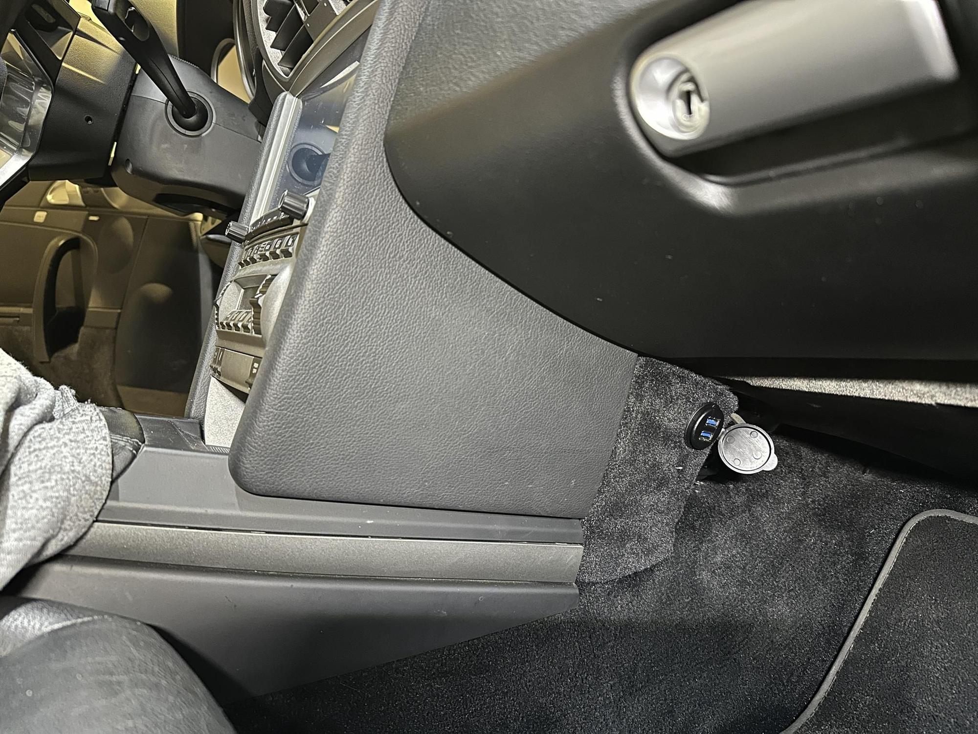

The way I solved the USB plugs issue was removing the OEM lighter in the passenger side and adding a female USB plug that is connected to those cables. Looks tidy:
