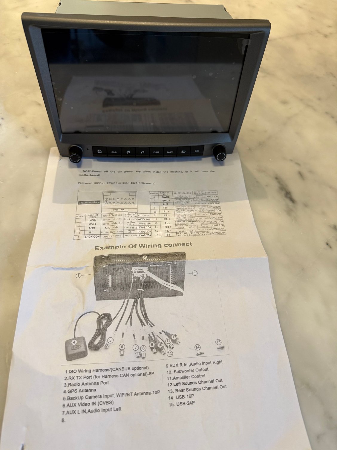

Did anyone get instructions with their head unit?
Mine only came with one page that looks like another stapled page has been ripped off of it. Also, there are no directions - just a diagram showing the power interface and witing connections.
Am I missing anything?
OK - I think that I have everything plugged in and ready to slide back into place. I mostly have 4 issues now:
1. The unit doesn't have CarPlay which I thought it did. I don't use Android. Is it possible for me to download Apple Carplay?
2. Next - the volume isn't as loud as the stock radio. Mine is a Bose system and has the optical amp controller. Before I pulled out the old radio I maxed the volume and then turned off the radio. I'm guessing that I was supposed to max the volume and then turn off the car(as opposed to the radio)?
3. The CAN-BUS must not be connected somehow because the dash display still shows "Radio Off" when the stereo is playing.
4. I bought 3D printed mounting rails and none of the holes line up. Does anyone have a picture of what these are supposed to look like mounted on the unit?
Can anyone offer suggestions to help with these? Thanks in advance!
1) all of them do. App is called carlink or Zlink, depending on if using a FTY UIS78xx or Qualcomm unit
2) unsure, never run into this
3) the DIS display requires the 2-wire canbus plug to be connected from the canbus box to the HU itself, and for the HU to have the correct canbus box type set. If the box weren't working or connected, your unit wouldn't power on, so that's not the issue.
4) you removed the factory metal guides, right?
