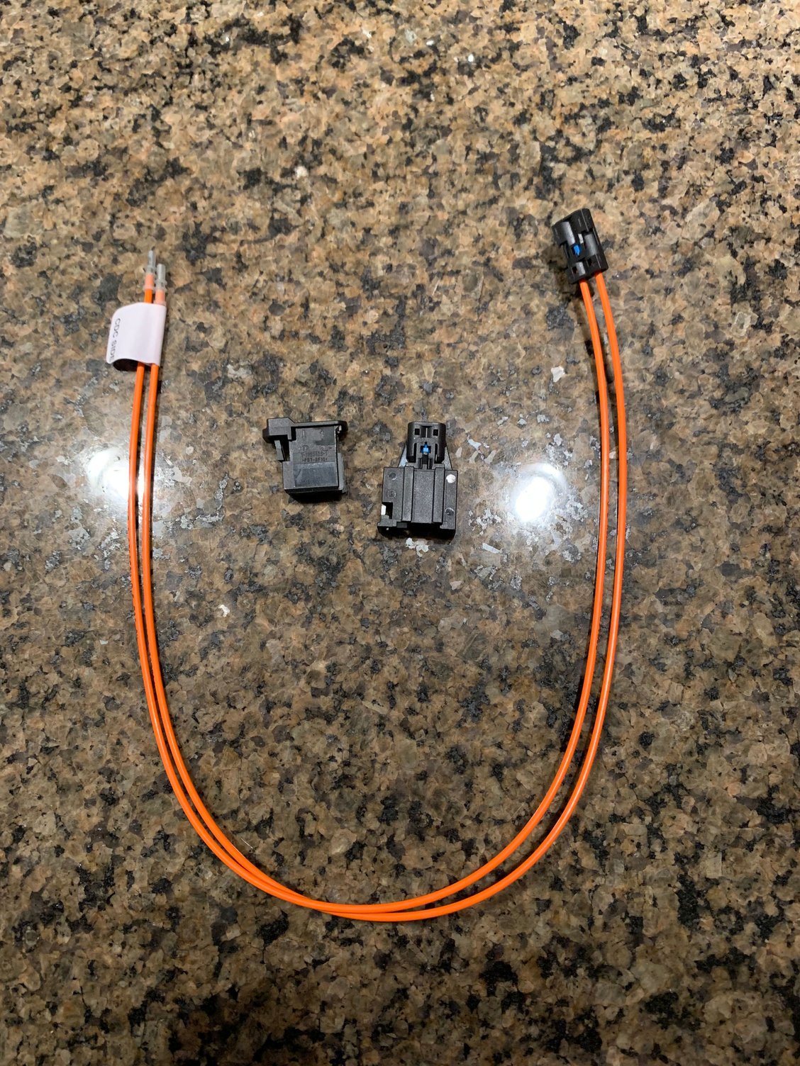

good suggestion on dension - I found this https://audiojamonline.com/dension-f...xtension-cable - which should do the trick. Assuming the picture is accurate and both cables are sent. The picture is similar on the Dension site, so we'll see

Think I have an extra. Let me know can send a pic.
@kellen yeah shoot me a picture. I have a solution coming but would still prefer an original I think.
Will do. Give me an hour. I added my Dension and had leftovers. Happy to send one or two cables out.
