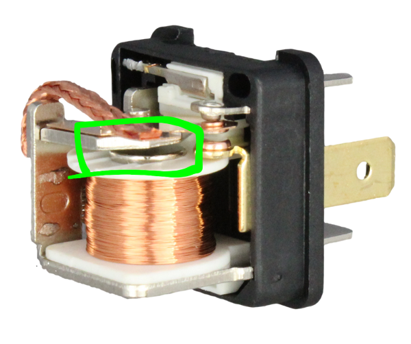

A fairly easy test to indicate faulty check valve at the fuel pump is to bridge terminals 87 and 30 (+12V battery voltage, always live) of the fuel pump relay after 45min before you turn the key to start the engine. If it starts like the cold engine, then it is indeed the check valve.
Easiest way to bridge 87 and 30 is to remove the cap of the relay and stick a thick enough feeler gauge blade between coil and 'lever'
