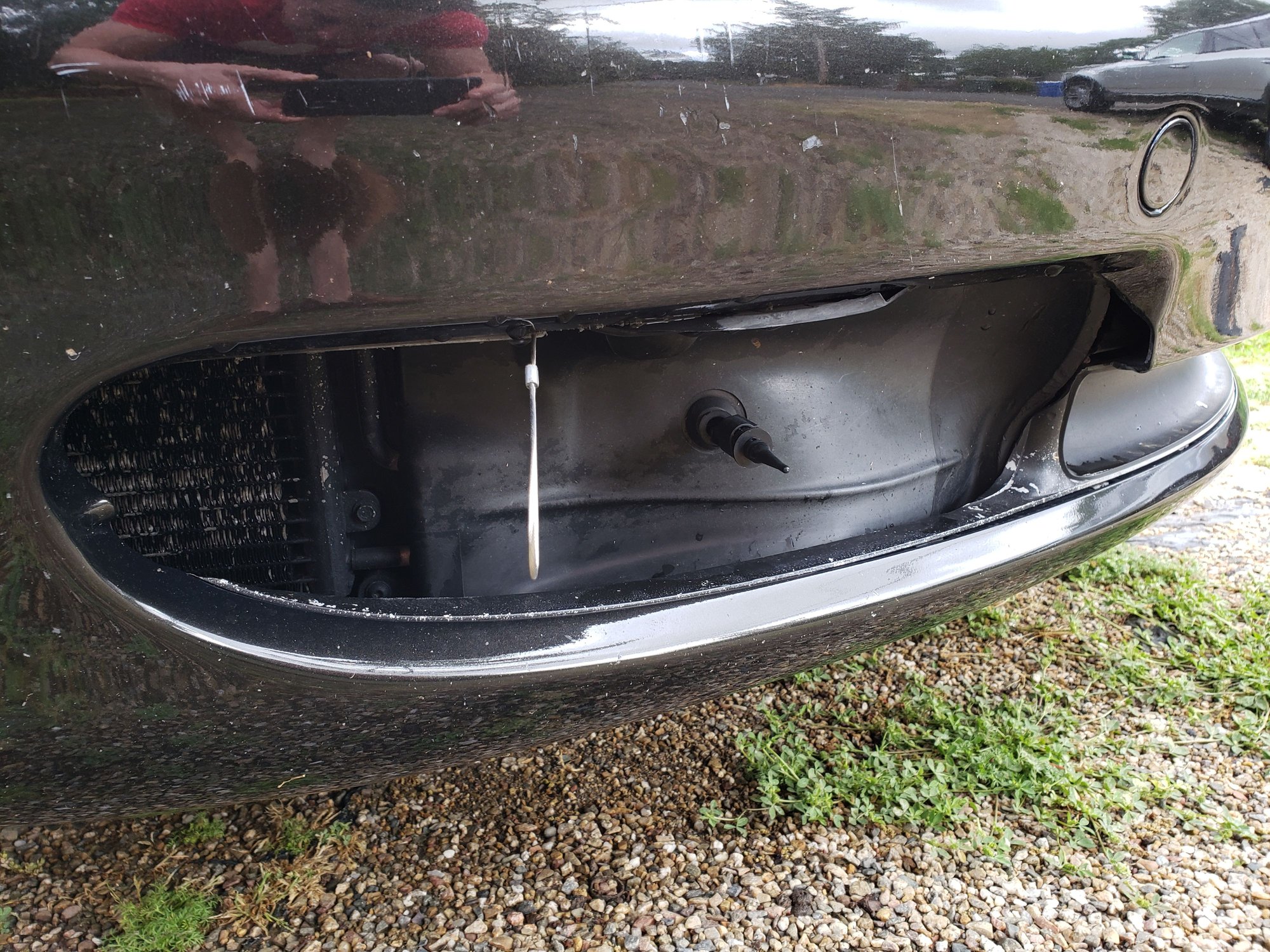

1. Front Bumper
a. Bumper insert is missing. It looks like the something was cut out too. I would love to find a used one in Black Metallic.

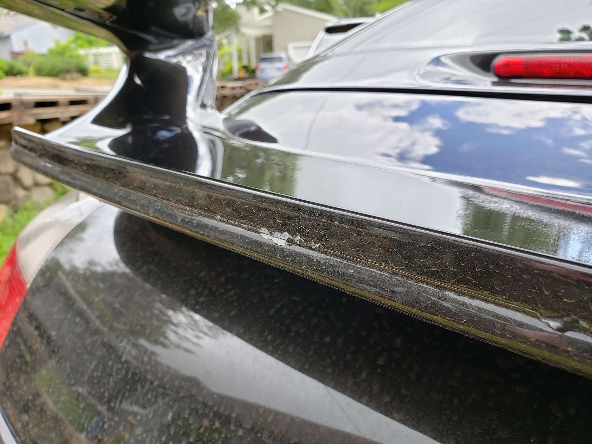

2. Rear Deck
a. I would love to find a local OEM rear trunk. I would also love to sell my Aero “Taco” wing. Both in Black Metallic.

Here are some pictures to help better see the front bumper:

1. The bumper insert will be standard black, they all are.
I would go with a used one if it were me.
Check here:
http://dcautocatalog.com/illustration/index/526909816
2. Rear deck, I would check eBay.
The Taco will sell if you'll ship it.
If you won't it might take a while to find a buyer.

Looking a the pictures, looks to me that you already have the third radiator installed by a previous owner. This is good.

I have a complete rear deck, all stock that I removed from my 996.1. I bought another one to modify for my rear spoiler. It's in excellent shape and black, but mine is L741 black, not black metallic.
Hit me up if you're interested.

I just sent you a PM.
Full disclosure - the paint is pealing a little. See image below. Also, sorry for it being so dirty, it just rained here...
