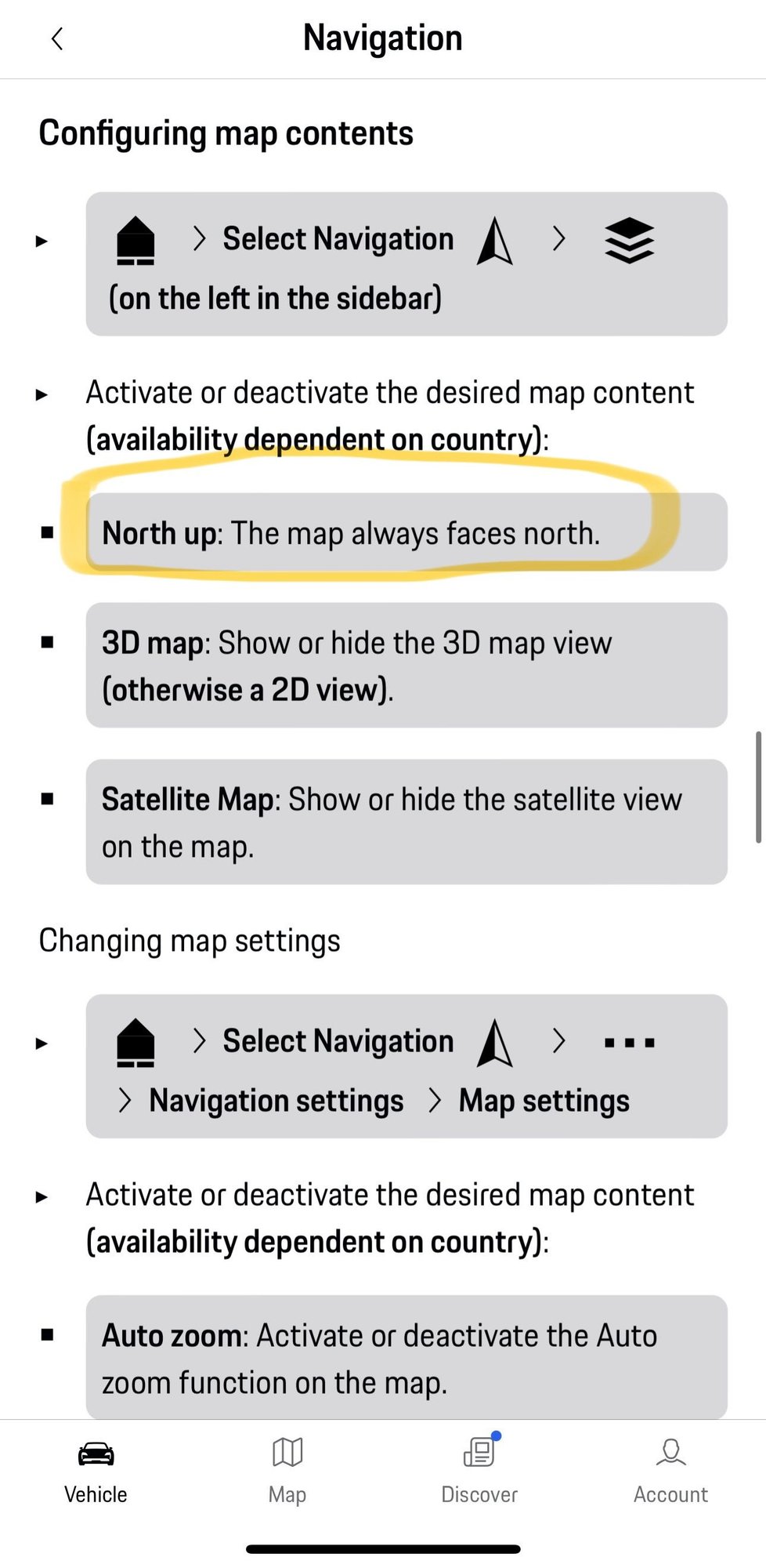

Is there a way to change this nav map so that the heading (arrow) is always pointed up?

i have not tried it yet, but according to the manual there is a setting.
for navigation direction i usually use my iPhone (carplay) and i already set the map to always pointing north
