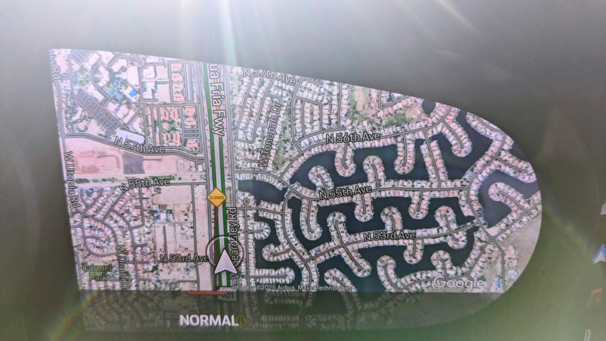

Any update? Had my 2024 almost a year now and still can’t use the nav right half screen due to this bug…

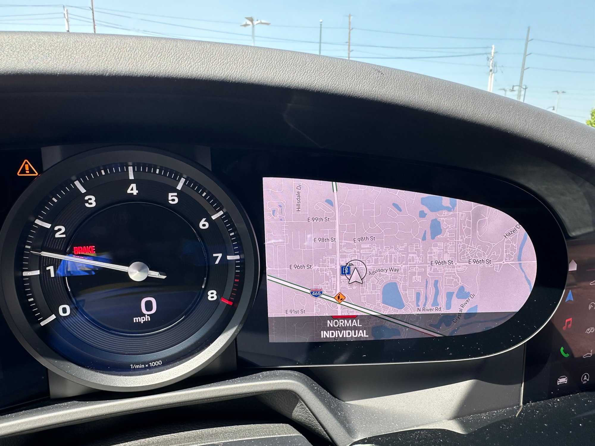

Good news. I had my 2024 Porsche 911 Carrera T in for some other service, and I also had them upgrade the PCM software as per (Bulletin #: 2423.1 Part ID: 9025). They did verify that the cursor was hidden by the steering wheel, and then applied the PCM Software update. I can report that it did indeed fix the issue.
I did not lose any settings or any personal configuration. I had to re-login to the PCM with my PORSCHE ID, but all of my settings were there.
So for those who are having the same issue, during your next PORSCHE service center visit, indicate that you are having the issue with the "Instrument Cluster Navigation Arrow Off Center" and that they should follow the bulletin noted above for correction action. I also took a copy of the bulletin with me as well and handed it to them.
Thanks for posting the bulletin.
Just got my car back from 1yr service and before it went it was picked up, I made sure they knew about the bulletin and sent it their way just in case they were unaware.
All taken care of now:
